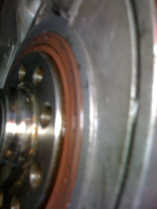

Does it matter if the front of the seal (facing the flywheel is damaged? I got pissed and did this ---->
It is flush with the casing

What have you done?
I suppose that if you thought the RMS would not leak, maybe you would be correct. I have not tried this method of "upsidedown" or in your case UP side IN.
It may actually work.
I doubt it because of the method of insertion. Is this your second seal?
It has to go down to the base of the seal cavity. There is a ledge on the outer block about 1/16 wide that is the bottom for the seal outer edge. I do notice your block does not have my "bevel" but you MUST BOTTOM the seal below the block and not flush.
The Pelican OEM KACO seal--bottom--would work best for you. It does not have the "RIBS" on the "bottom" half and would start easier. Both will work.
Take a screwdriver in the screwdriver access slot and remove the seal. You cannot save the seal.
Begin again. The memory of getting to the seal is not worth the $20 it will cost you for another seal.

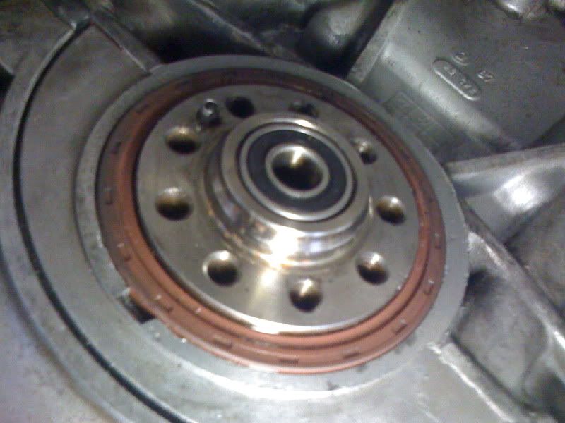

Shogunther,
The PO of your car had the same problem. In your previous post ..."look what I found" your picture showed no RMS. Here is your picture.
Removed the clutch and look what I found...
Every thing looks normal. Make sure you have no burrs in the screwdriver recess area or poking up towards the crankshaft, clean the opening and crankshaft. Use liberal amounts of WD-40 or Curil-T. Oil the inside lips of the RMS with thick oil. Buy a 4" screw in sewer cap at HD-take your old seal along for measurement. Gently tap the RMS in. The KACO seal without lower ribs will start easier.
Good luck
John_AZ

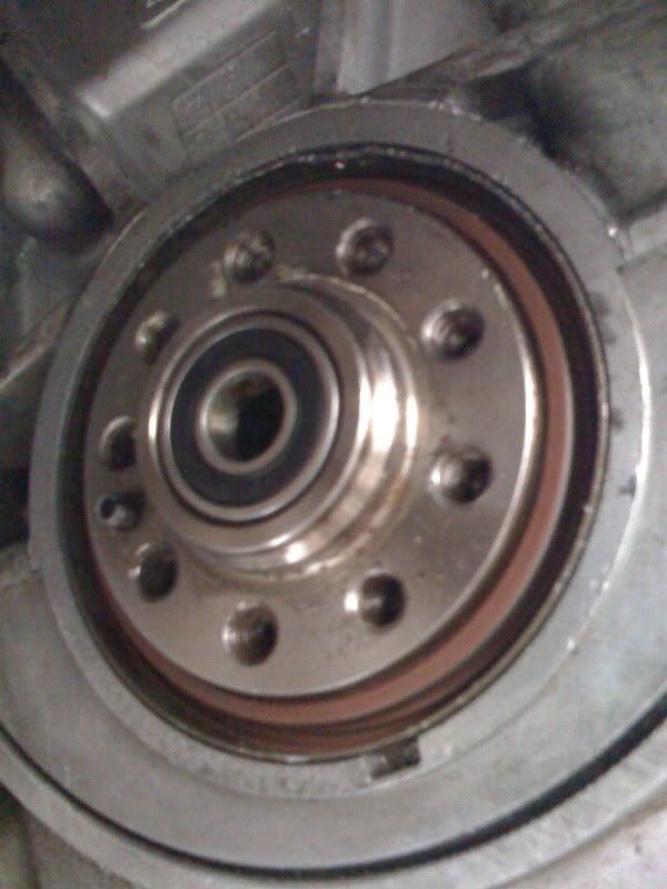

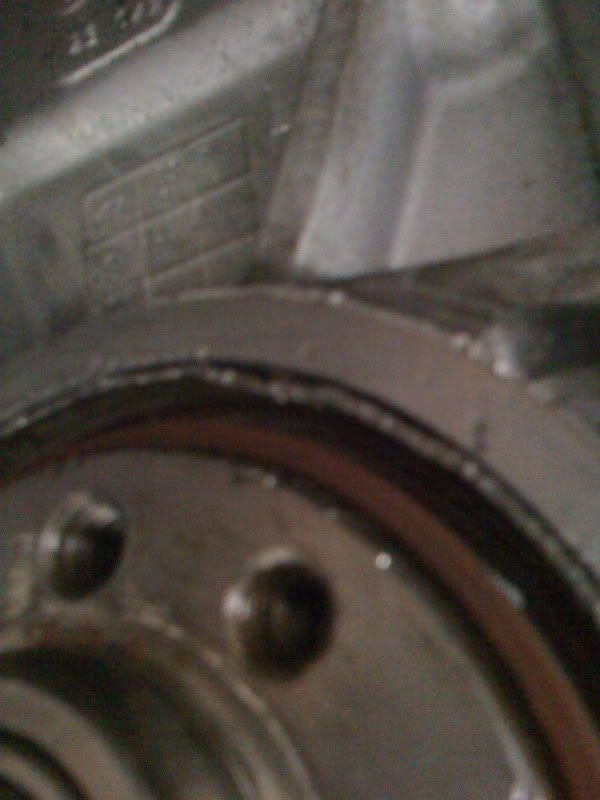

So the seal should seat in with gentle taps? I am hammering this sucker and it wont go in any further, but it is still sticking out a little.

snap a pic!

I measured my "old" OEM seal I just took out of my 1987 924S-it is ~12.2mm thick measured with a cheap Harbor Freight caliper. It is red/rust in color and has ribs top to bottom. The seal prior to removal was "almost" flush with the block-just a tiny bit below.
The OEM KACO seal Pelican sells and the one I just installed in April is a little less than 12mm thick and has ribs only on the top/outter area. My conclusion/reasoning was that KACO wanted a fresh surface on the crank to seal, a little deeper if you follow me, and that is why the seal is ~12mm thick. You can see it in my earlier seal picture.
I also measured, again roughly, the depth of the seal "ledge" from the block face to the ledge.
It is about ~14.7mm. The block face to the bottom of the screwdriver slot is ~7mm.
I do not know what brand of RMS you are using. If you measure the seal that you put in upside down and you got it flush, the seal you have just put in should fit.
Yes, the Arbor tool Pelican sells would do the trick. Did you get the 4" sewer cap to help you install this seal?

I don't want to start any other issues, but from the last picture it looks like the seal is deformed, like it is too large a diameter. Perhaps it is the wrong seal?

I would do as John suggested, measure the seal you just put in....it may be in as far as it goes.

I finally got the RMS seated. Now another problem.....I was torquing the flywheel bolts and one snapped. Do I need to remove this or will it be ok with 8 bolts? What a PITA this has been!
