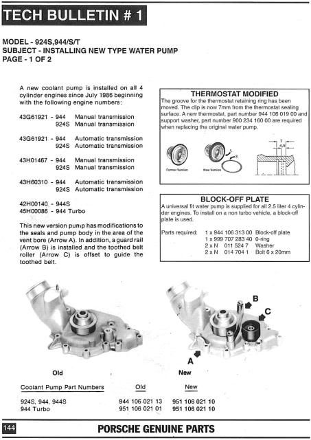

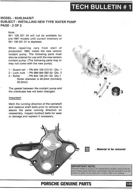

I am a newbie to Porsche's and I am changing the water pump, belts, ect on my sons 83 944, and have the updated water pump with the guide. What do I do for the back timing belt cover? Do I have to drill two holes for the guide mounts on the water pump to fit through, or do I need a different rear cover? Also I need a 46mm idler pulley thats larger than my original?

The rear cover can be cut out with a dremel or buzz saw. It's very easy to do. There is a factory bulletin of the outline that needs to be cutout that I had but not sure if I can pull it up because i'm posting from my phone..

Thanks Techno, that's great news. Would anybody have that bulletin so I can see how much to cut out?

took some time to figure out how to do it from my phone..
on second look this is actually the wrong one... Doh! But the last picture shows the center portion cut out for the updated pump. I have the actual bulletin somewhere on my
laptop, can post it Tomm. Morning.

While you have your cutter out, split the inner cover where it goes over the crank sprocket. You'll end up with a 2-piece inner cover that makes water-pump changes in the future much easier. You won't have to get the crank sprockets off to take the inner cover off to get to the water pump.

Back on land.. . Here is the tech bulletin.
