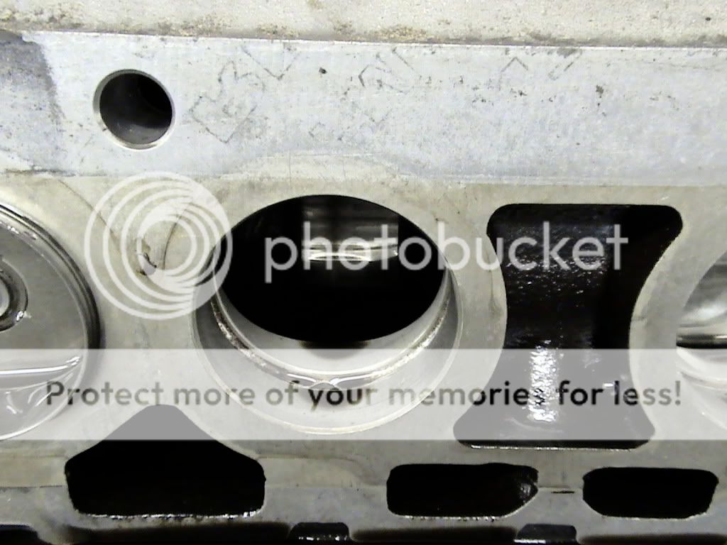

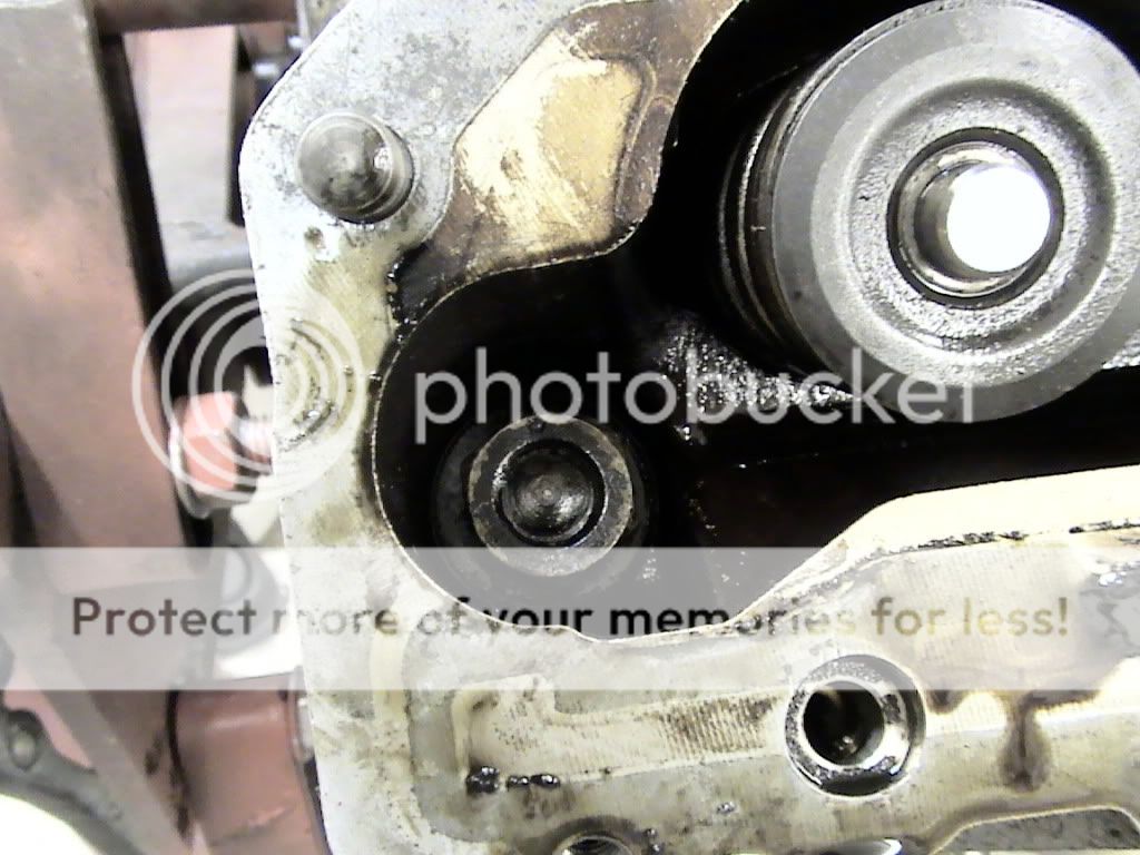

Here's some of the most recent pictures:
This is the bottom of the cam housing with the lifter still in:
[IMG]Photobucket[/IMG]
I didn't have any problems with them falling out when I took the cam housing off but, it's a good idea to have someone help you catch them and remember where they came from.
Here's the the housing with the lifter out:

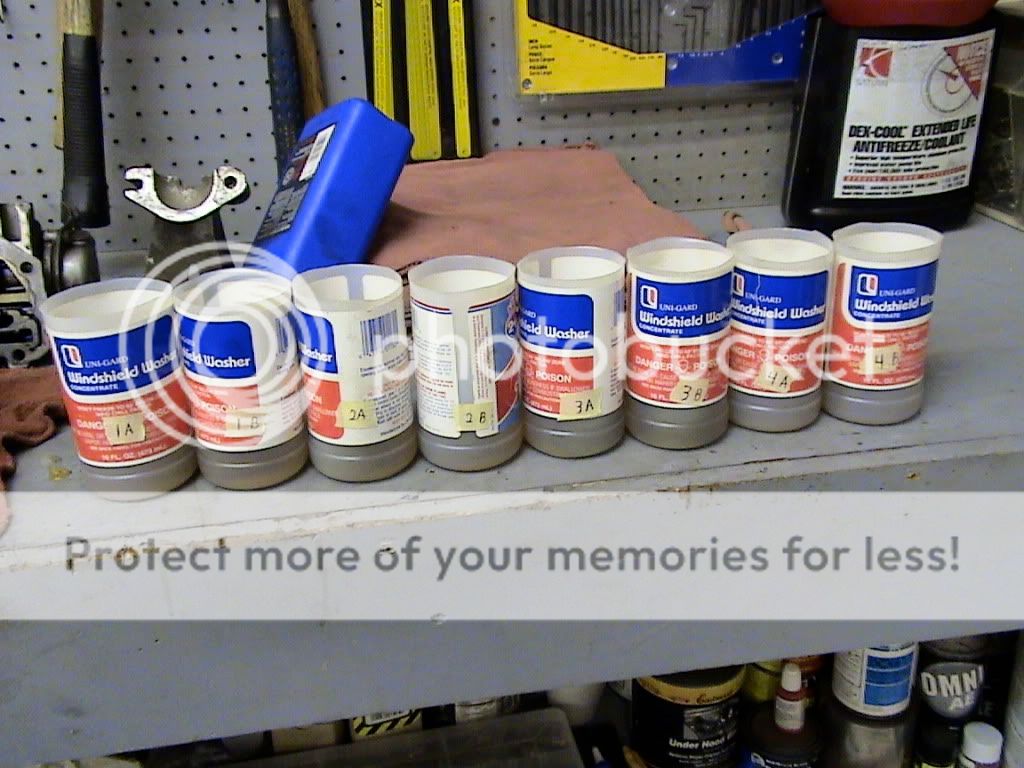

They come out pretty easy even though they're slippery with oil. If you have any trouble getting a grip on one you can just turn the cam shaft to push it out a little further.
Once they're out make sure you know where they came from in the cam housing by marking them. Also, you have to keep them in oil because otherwise it takes a few minutes for them to get oil when you start the engine up again. And as we all know no oil = bad news. What I did to both keep track of them and keep them lubed was use eight small containers, individually marked, kept one lifter in each and filled them with oil. It only took about a quart of oil.

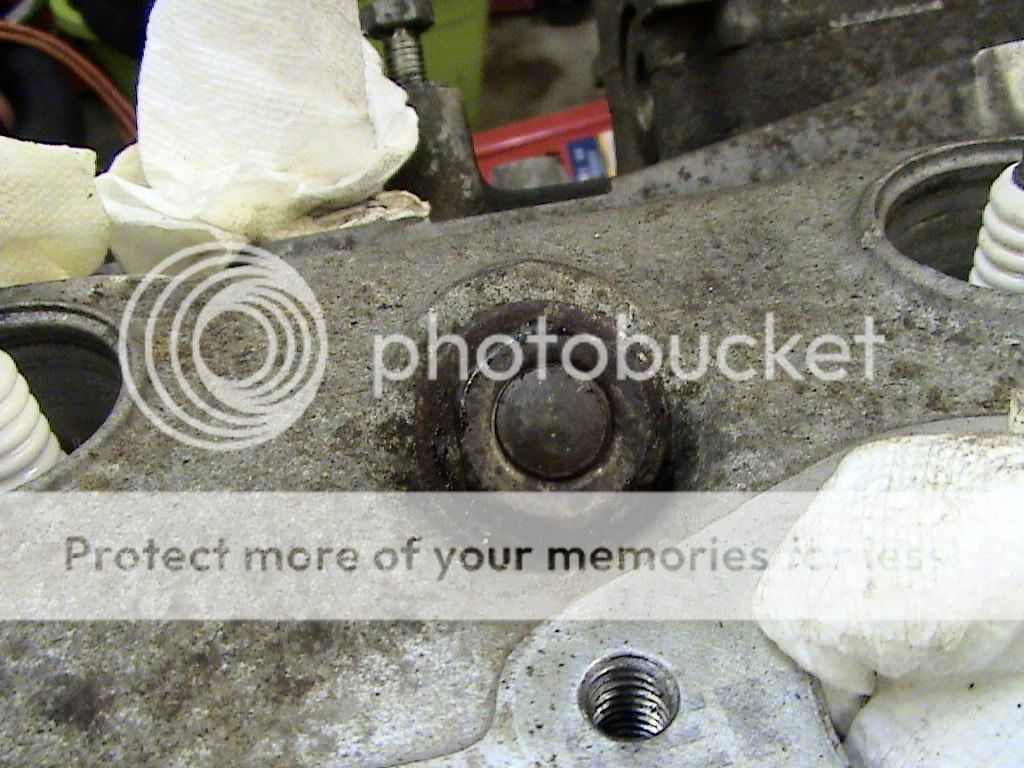

These are the cylinder head bolts:

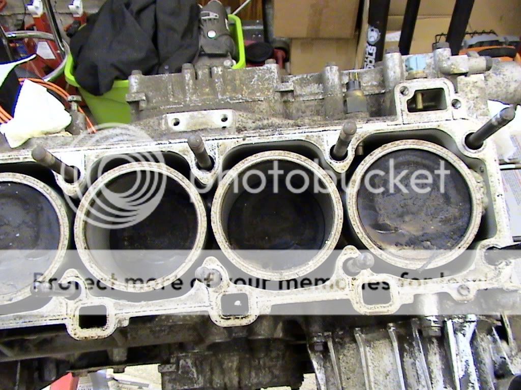

Remember to learn from my mistakes and take the head bolts off in the correct order! And if the head doesn't want to come off at first gently pry the tabs on the sides. Don't pry the gap between the head and block because the soft aluminum can be damaged easily and the head won't seal properly anymore.

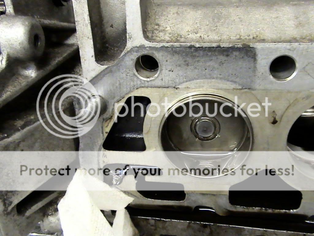

This is what it should look like once the head's off:

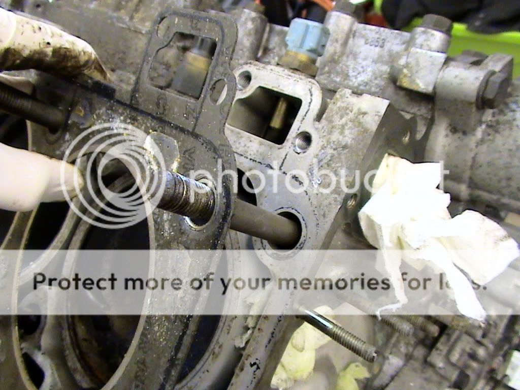

From there the gasket shouldn't be too hard to get off:
And here's what it'll look like once the gasket's off:

The picture of the cam housing with the lifter removed made me do a double take...is the tip of that cam lobe actually tapered off from wear on the rightmost third or is that just a reflection that makes it look that way?
Looking good so far.
1987 silver 924S made it to 225k mi! Sent to the big garage in the sky
Old 04-22-2010, 09:16 PM
Aufenbahn's Avatar
Location: GR, West Michigan
Posts: 266
I think it's probably a reflection of the round hole you're viewing it thru.
Andy D.
Currently driving 2005 Audi A4
Currently driving 2006 Ram 1500 sometimes
Old 04-24-2010, 12:23 PM
"Dude! You kicked my car.
Rudeboy42's Avatar
Join Date: Jan 2010
Location: Connecticut
Posts: 375
yeah Aufenbahn is right it's just the reflection from the hole. That'd be scarry if it was that badly worn though.
