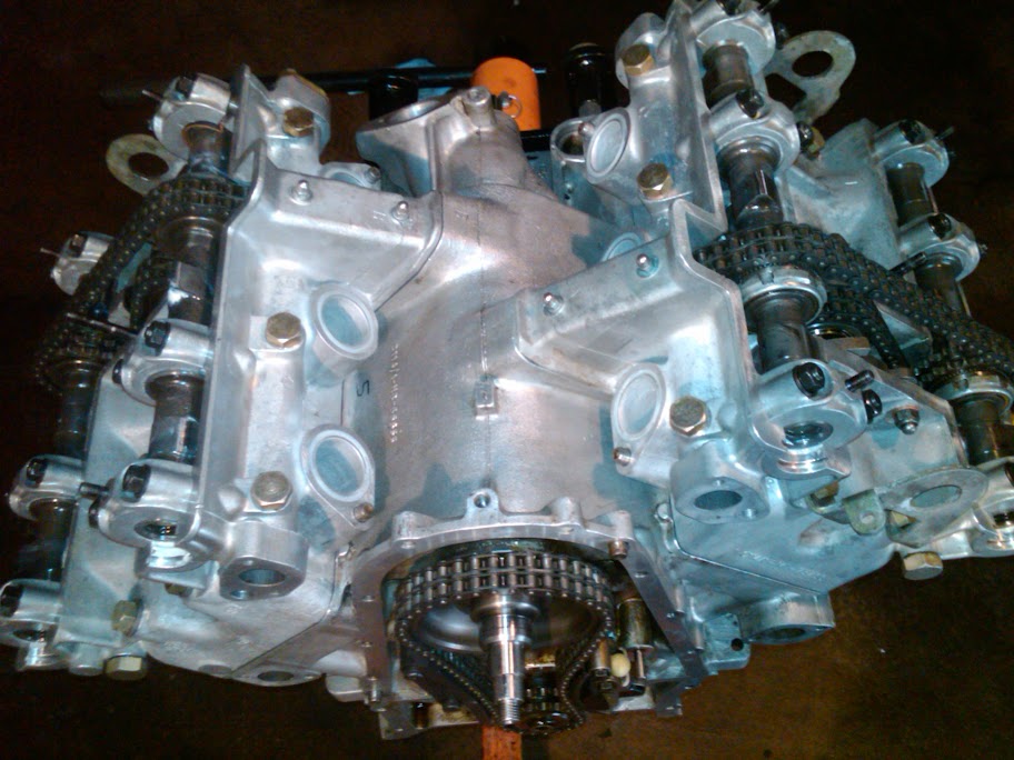

@ Bukowski: You're correct of course, the pin is slotted, so the rotor only goes on one way. Apologies for the confusion. Again, I'm more familiar with engines where the distributor is geared off the cam, or for added fun, off an auxiliary shaft. In that type of arrangement, knowing which TDC you are at in the engine stroke is important because it is very easy to install the distributor 180 degrees wrong. Anyhow, let's just say working on a 944 8V NA motor has been pleasant compared to a Maserati V-6 with about 6 feet of timing chain: http://tinyurl.com/hbk5ju7
