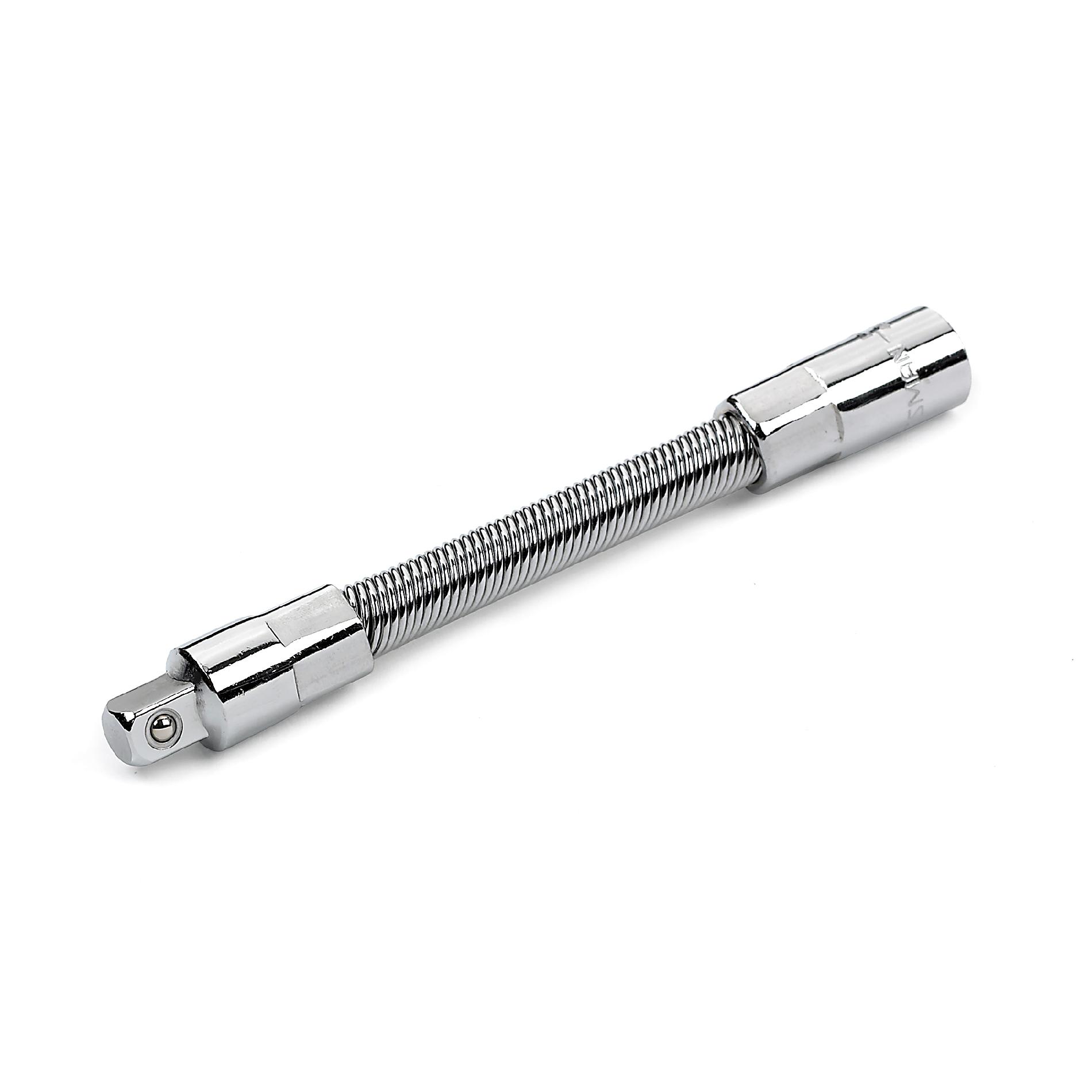

Yes, on the larger broken "B"hole, there's a sleeve. From the deeper gouge, the figure-8 spacer/washer is missing. And the adjustment bolt wasn't tight enough and vibration allowed the bracket to drop onto the flywheel teeth over time.
Don't use little L-shaped allen-keys. Not going to get enough torque. Use a 1/4" flex-cable extension.
