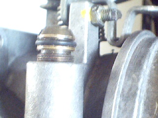

Question calibrating body throttle and air flow ?
At last, today I saw my engine bay fully assemblied ( nice sensation) after 2 years of saw only parts.
My engine starts but not at first crank, and the idle is high.
AIRFLOW METER
Today I change my airflow meter was very difficult to take out one bolt from the air filter housing ( I bought this rebuilded maf about 2 years ago ), I try to test with a multimeter the 2 maf (old and refurbished) like say in the haynes manual but both gave me the same reading and is not near of the specs in the book. but if both maf gave me the same then I believe both are correct.
I replaced because the refurbished blocks cover is already removed then I can adjust.
Tomorrow I will do this job, I´m planning to folow the instruction of early944.tripod.com to adjust the co level with the oxygen sensor, do somebody already did it ?, waht capacitor range I will need ?
THROTTLE SWITCH- is perfect
BODY THROTTLE
what is the correct setting (rpm,etc)
Let me know
regards

Sounds like an idle CO issue, you may have a rotten o-ring on the idle speed set screw. It's a brass screw in the throttle body, but you need to bypass the idle speed control motor in order to adjust it.
Near the brake resevior you will see a plastic cap about the size of a pocket watch. Open the cover, you will see one pin that is away from the others, this is the ground. Run a jumper wire from the ground pin to the second pin from the top looking at the battery side of the car as the top. to bypass the idle speed control valve.
Again I wish I could dig up the pucture of the diag port to show you the pins, but I can't find it as usual.
Also after sitting for two years I would remove the throttle body and clean it up.

Are you talking about the throttle stop screw? If so DO NOT use it to adjust your throttle in any way. Just to make sure we're on the same page: Throttle stop screw (sounds like a track side cat house) is a piece of allthread with a slot on the back and a nut that when adjust right, touches a plate at the same time your throttle closes. The idle speed screw is a largish screw in the side of your throttle body that sinks into the body. That is the only thing you use to adjust your throttle.

Here ya go, Ed, just so I know there's no language SNAFU:
Idle adj. screw out of throttle body
Started in hole, can change the o ring like that should you want to.
How you'll see it in your car.
Throttle stop screw, not to be used to adjust idle, just keeps the butterfly from over closing.
