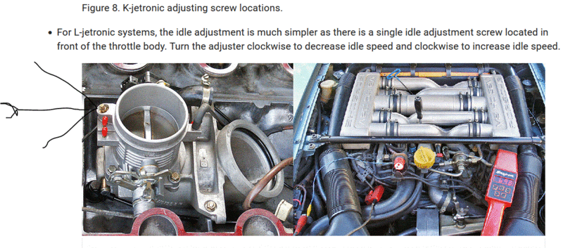

Note Idle Speed adjustment :
Their is an Idle adjustment I read and I tried that no Luck as it was all the way Down
CW but the Motor Kept racing Badly, As A test I open the adjustment Up some CCW
and the Motor speed increased went to 2000 RPM's
Shut it down and removed the adjustment ( Brass ) and I am not sure its really an adjustment but perhaps ?
This Adjustment is in front of the Main intake Body direct into the motor See Photo
attached . Black Handle with extension to turn a 7 mm socket to adjust

Ok so if it's an idle control valve we are discussing then they are actually very simply to clean. No need to open it up.
I've had many old bmws using bosch ICV's that needed cleaning. If you simply soak the mechanical valve end in some sort of degreaser (purple power, solvent, etc.) over night it usually frees up the flap inside. you should be able to hold it and move your wrist and feel the valve inside clanking back and forth. I would suggest trying this before seeking out a whole new unit.
Also the rubber hoses attached to it should be check for cracking as leaks would also cause the ICV to operate funky.
-Matt

Yes the ICV Can be cleaned just be careful not to get the Motor End Wet / Moist.
Also I researched that is some kind of Temp Switch I think that works in conjunction with ICV
Basic Operation I believe is that with " Motor COLD " the Valve is wide open and Fully warmed up completely closed. With it wide open induing a Vacuum Leak like situation the Motor speeds up Thus becoming the Choke until Warmed up,Valve closes Idle becomes Normal .
After driving the car The ECU learned my fooling with the ICV and I retested the Main intake Idle adjustment and found that indeed that it does set The idle speed very effectively
