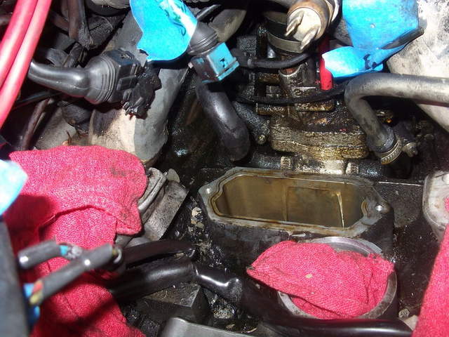

I couldn't handle the oil filler neck leak anymore. The valley full of oil was keeping me up at night.
Figured I would hit a lot of other issues while I was in there.
Needed to do my first TB/WP anyway.
I decided to rebuild the stock tensioner, mostly because I wanted to learn the system but also because there is no porken option right now.
Plan to rebuild water bridge and replace T-stat as well as all hoses and belts.
Started the tear down this week.
For a change I went slow and bagged and labeled everything.
Only issue getting water bridge out was managed to strip a hex bolt at driver's side rear.
The filler neck was pretty nasty.
Not bad to get to, but hoses to neck were brittle and fell apart.
I couldn't even find evidence of a gasket...not even residue.
Plenty more to come.
Tips to the rookie are welcome.

Well - that could explain the giant mess - uggh, it looks like an o-ring is in there but very flat looking - can't really tell...?
Are you going to strip & refinish the filler? At least with the metal oil filler (and new o-ring) you should get a reliably good seal when it all goes back together - the plastic ones can warp.
If you have any thoughts of changing crankshaft oil control configs - now is the time to configure for it...?

On 85/6 cars the hoses at base of that filler neck harden, crack and then spray oil mist across top of 32V engine. Replace them and the gasket, should be good to go.
Those same vent hoses, if original, will also be nearly dissolved and soft on the approach to the cam cover. At base, they crack.
Its one of those items on the permanent refresh list that must be changed on any 85/6 that you bring home.

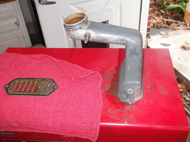

The filler neck is being prepped, but I do have a concern about the metal baffle/O-ring combination.
The components aren't secure to each other and I had heard it is now NLA.
I measured the opening on the crankcase and the metal baffle overlaps the hole. I assume it would be stable when I button it up, but I certainly don't want it to shift around.

The baffle I was talking about is not that one. You can get a baffle box that drops down into the crank vent... you can ditch this baffle plate then and use a stock gasket above/below.
Greg Brown & John Kuhn make them - do a search
Alan

I repaired the stock baffle just in case.
The filler neck went well and the clean up is in progress.

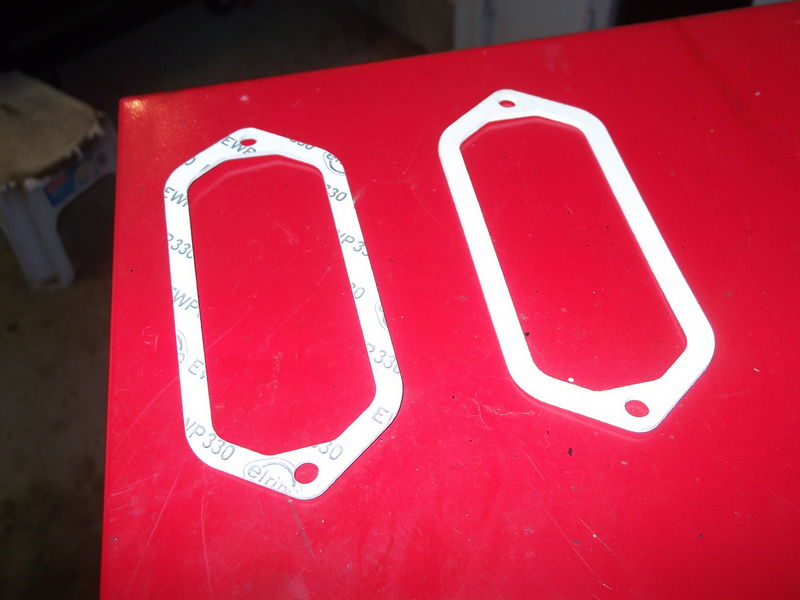

I'm going to try the stock baffle first with these gaskets I got from Roger, and see how it goes.

Cleaned and rebuilt the water bridge with new gaskets and T-stat.
Inner gasket was essentially cooked off.
I also had been missing anything resembling these gaskets as well when I did the tear down last week.
