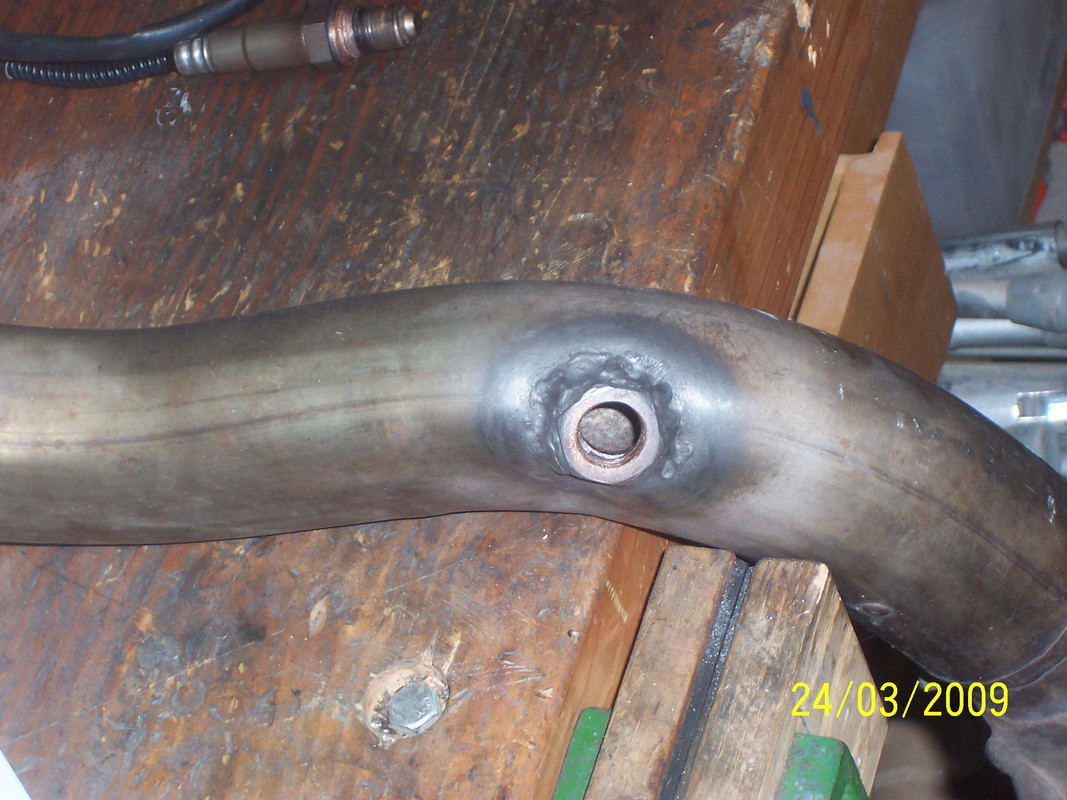

I have been in the ongoing process of enhancing the engine control by adding various sensors and feedback systems to the DME/KLR. Posted in the KLR and WG threads. So now I am at the O2 sensor part. I have been using a WB from Bosch a LSU-4.2 for a while, the issue is that I have been using the existing sensor mounting bung upstream from the turbo. I realize with the pressure and heat prior to the turbo the life span of the sensor would be low, as it turns out after 10 years or so of sensors, it works out to about a sensor a year. Which while not ideal is acceptable, the problem is that the sensors fail in unexpected manners with the wrong readings/ slow response being the most troublesome.
So the question is this:
If I were to close of the original bung and put a new one past the turbo, just before the cat how much latency would this generate ?
I believe that the gas passing over the sensor should have current enough O2 info so that the DME is not out of step when it applies fuel trim. Is this assumption correct?
Thanks Sox.

just added info, I used a bung cap to plug the old sensor location, it leaked till I put a copper crush washer on the cap.

BTW my install, I used a step lap joint clamp as I would like to be able to disassemble the exhaust at this junction. Also I always use exhaust seal compound inside the clamp to pipe seal.

Testing the WB O2 in the the position of the original O2 sensor (just before the turbo) versus where I have it now few feet downstream of the turbo, I can see a definite lag in the readings because of it being further away from the engine.

Yup conclusive,
Car systems lag time (processing, injectors etc.) is about 140 ms maximum.
O2 sensor response (Set to instantaneous when gas pocket hits the sensor) in original pre turbo spot is about 395 ms including the above system lag time.
O2 sensor response at post turbo spot where I have it is about 850 ms including the system lag.
So in my opinion 0.85 of second is to long a lag for it to be used in real time closed loop control.
The reading were all done at 3k rpm, the time measured from WOT to AFR dropping suddenly as the car went in enrichment mode. The error in measurement is +/- 33 ms.
