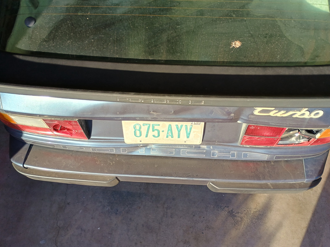

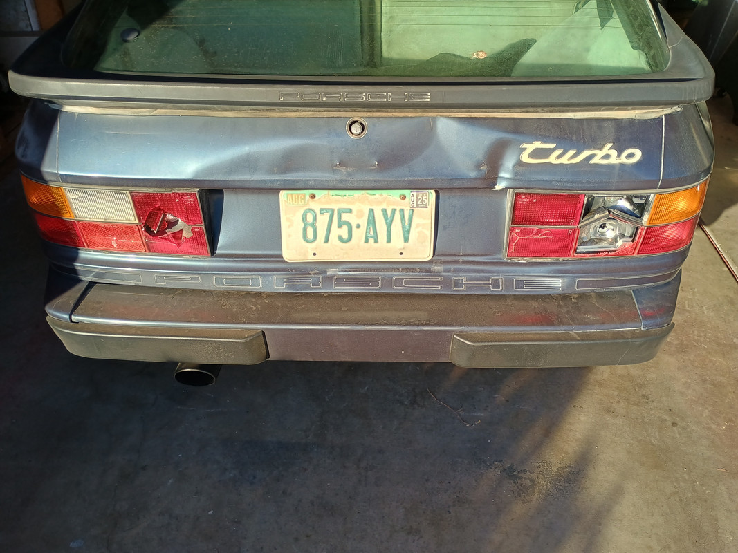

I was heading out to an appointment late Friday morning, and just about to turn onto the highway entrance near my home, and some a-hole behind me in a recent F-150 decides to go before the light changes:
I proceed to start getting out of my car, and that's when they decide to take off.
So I get a hit and run moron who basically totals my car and gets away with it - ARGH!
Par for the course for Phoenix, in my experience...

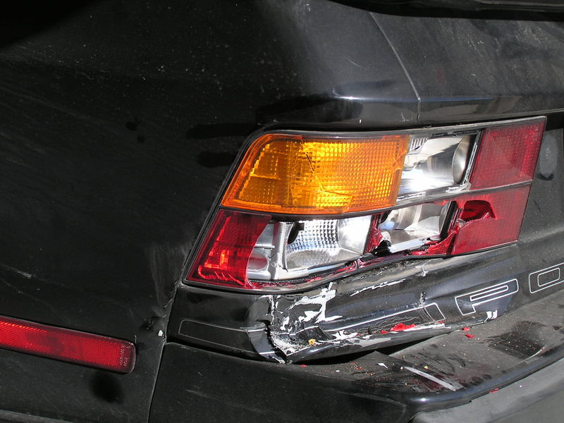

Did not get a look at his Plate I would guess.
Sox.
Here was mine from a while back.

Didn't even see him leave, very tricky.
How did you repair that hit, Sox?
A friend has a rear clip that I can get from him, so stay tuned (although it will be a while...).

It went to a dealership on the insurance's tab.
Mostly good, but they over sprayed in the hatch and the wiring and the options sticker was covered. They left the clips holding the side marker light off, wrong value of bulbs.....
small stuff.

that is very expensive to fix properly because it's spot-welded. to do a proper job you need to drill out each factory spot-weld to remove the panel, and then re-spot weld at the factory welding points which means a lot of manual labor hours.
around 15 years ago i think the total bill was around $11k for a repair that would pass factory inspection. insurance will try to total the car so be prepared to provide documents to prove the true market value if you want it repaired correctly.
