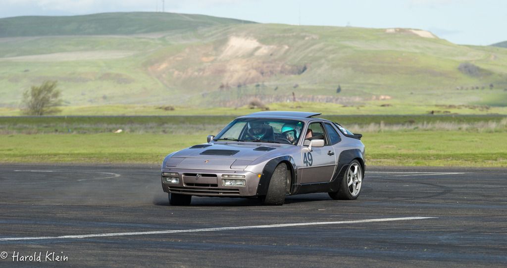

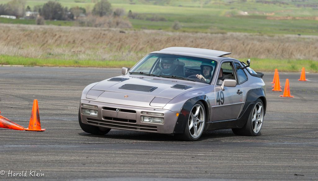

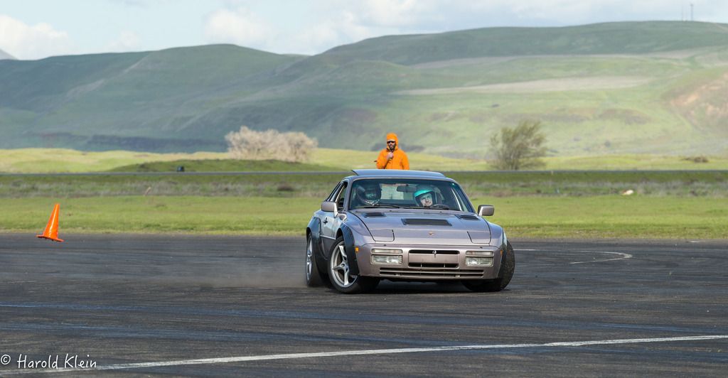

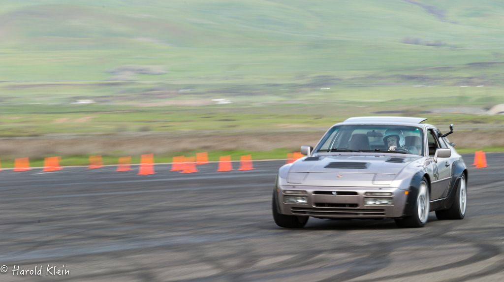

runs great with the new transistor. had a blast this last weekend shaking it down.
having to get used to having so much front traction now. needing some more suspension work im finding now that I can actually steer
needing to go stiffer all around.
woooops
woooops again... lol look at that cone go!

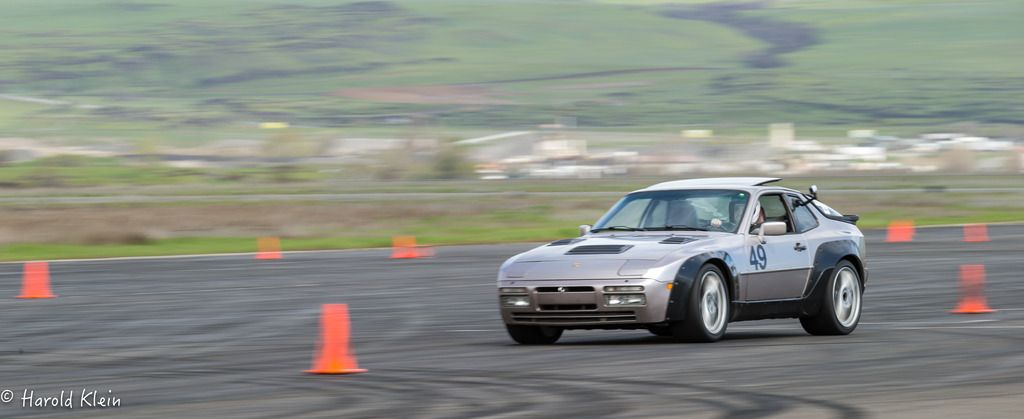

that's better

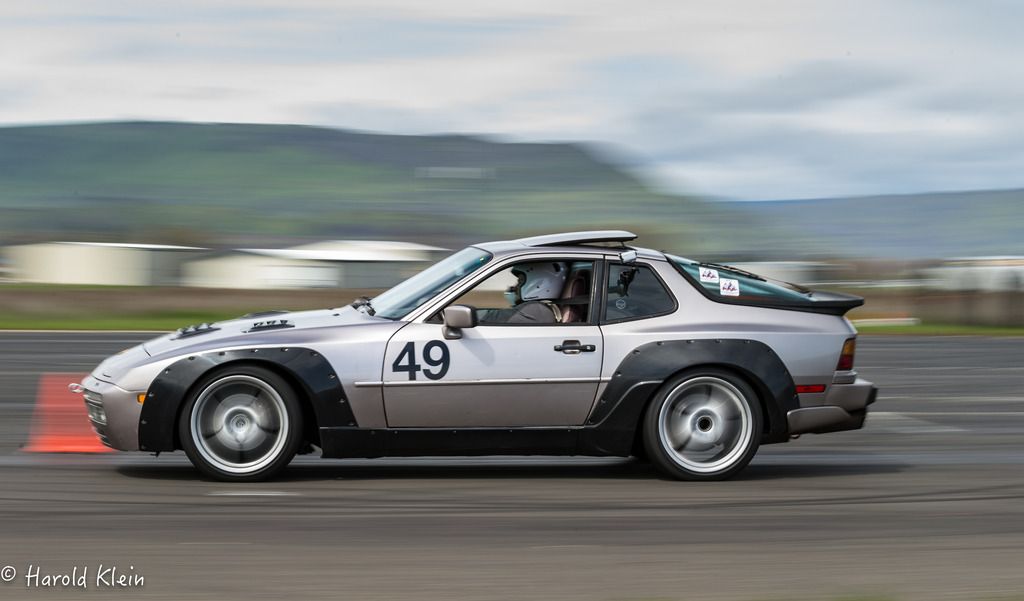

shes a big girl
