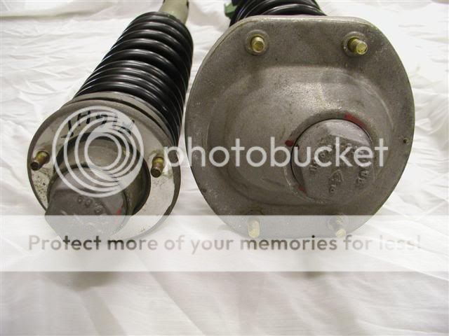

Sure, here are some pictures of the 964 RS and Cup parts. I will take some pictures of 964 RSR front and the 964 Cup rears when I can get them out of storage around here.
Below are the front and rear 964 RS suspension mounts:
http://i541.photobucket.com/albums/g...oballSmall.jpg
Below are the 964 RS (left) and 964 Cup (right) front suspension tops. The Cup part mounts the pivot point more toward the center of car for more negative camber.
http://i541.photobucket.com/albums/g...frontSmall.jpg

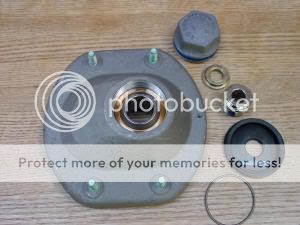

964 RS front strut mount disassembled:
http://i541.photobucket.com/albums/g...oballparts.jpg

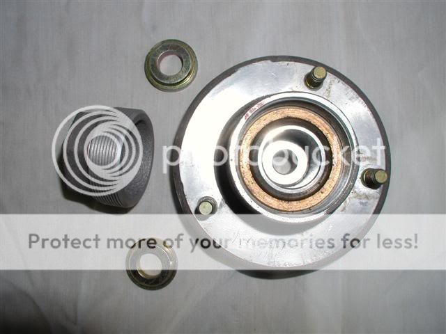

Rear RS shock mount disassembled (964 RSR is same, but with a hollow cap nut):
http://i541.photobucket.com/albums/g...rnalsSmall.jpg

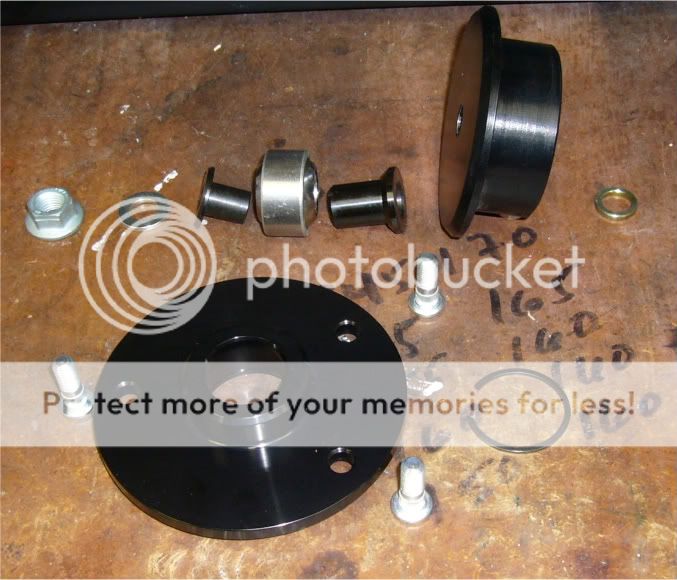

As promised, the rest of the 964 racing mounts, it took me a while to find the stuff. Here goes:
Below is an unassembled 964 Cup rear shock mount. The parts for the monoball are laid out left to right as they go top to bottom; I show the spring perch here for clarity since the small washer goes under it. The two tubular pieces on each side of the monoball telescope together within the monoball. The circlip is to retain the monoball into the plate and the studs are pressed into the plate.
http://i541.photobucket.com/albums/g...964CupRear.jpg

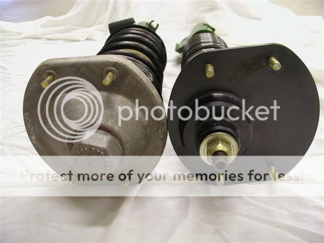

Below is a 964 RSR front shock mount. Note similarity to 993 RS mount Bill shows above which is a sealed version of the RSR below.
http://i541.photobucket.com/albums/g...r/RSRFront.jpg
Bill Verburg 05-02-2009 06:39 AM
Thanks!
So the Modes are copies of the RSR's
