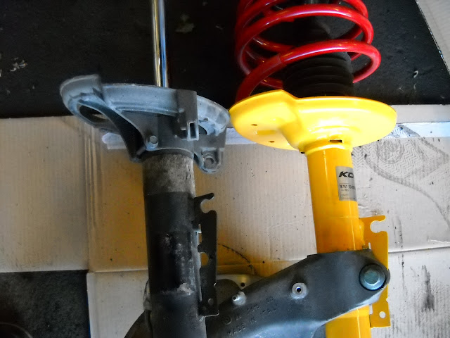

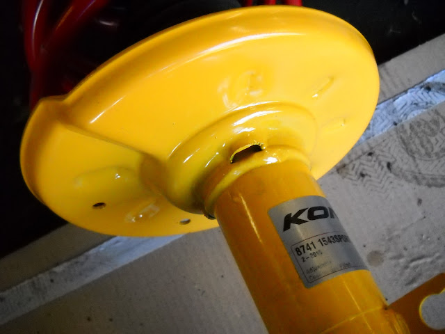

call me silly, but where does the sway bar link go now? purchased wholesale from tirerack for a customer car. Bilstein has an insert that's oem style, but the customer requested koni adjustables have a welded spring perch with nothing to attach them too. tirerack has been contacted and they're looking into it, and the customer comes back from out of town on tuesday so i hope they do something quickly... any input on the topic guys?

buyer beware, there is NO koni shock available for the 996 turbo, only the N/A 996. tirerack has their listings wrong... as well as Koni in some places.
