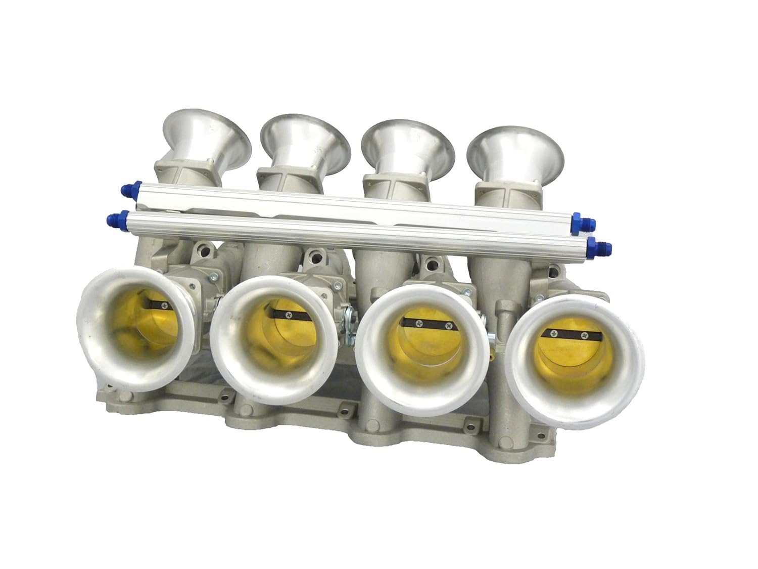

sparrott 06-23-2015 12:31 PM
ITB's
All these manifold issues on LS conversions, I am still waiting on someone to try these:
Amazon.com: OBX ITB Individual Throttle Body Chevy Corvette Ls1 Ls2 Ls6 Sfd52 Itb Kit: Automotive
http://ecx.images-amazon.com/images/...L._SL1500_.jpg
I know anything OBX can be scary, but it could be a good starting point over $4k jenveys.
not_hans_stuck 06-23-2015 05:10 PM
I love that manifold. I almost decided to use it. I didn't because I have an RSR wing and there's not much clearance at the back of the motor/back of the car. I also thought about using a carb manifold with a carb replacement throttle body fuel injection system but when I started this there were no good ones. Now there's that FAST one. It's pretty awesome.
I sorted my problem out with the manifold. You have to take it apart and install it in different sections. I had the folded manifold, the MAS and the air cleaner assembled when I was trying to fit it. It wouldn't go. I then lowered the engine a little and it fit perfectly. Then I raised the engine back up and it still fit perfectly. There was a quarter inch of clearance. Then tried running the wiring harness. It was too short to go around back (back of the motor, front of the car, over the crossmember) so I had to run it "through". That means between the GM Manifold and the folded manifold. That required me to disassemble everything separately. And that's when I discovered it would fit in parts.
Now, the cable won't fit. So I need to make some adjustments. I'll post photos after the adjustments are made.
