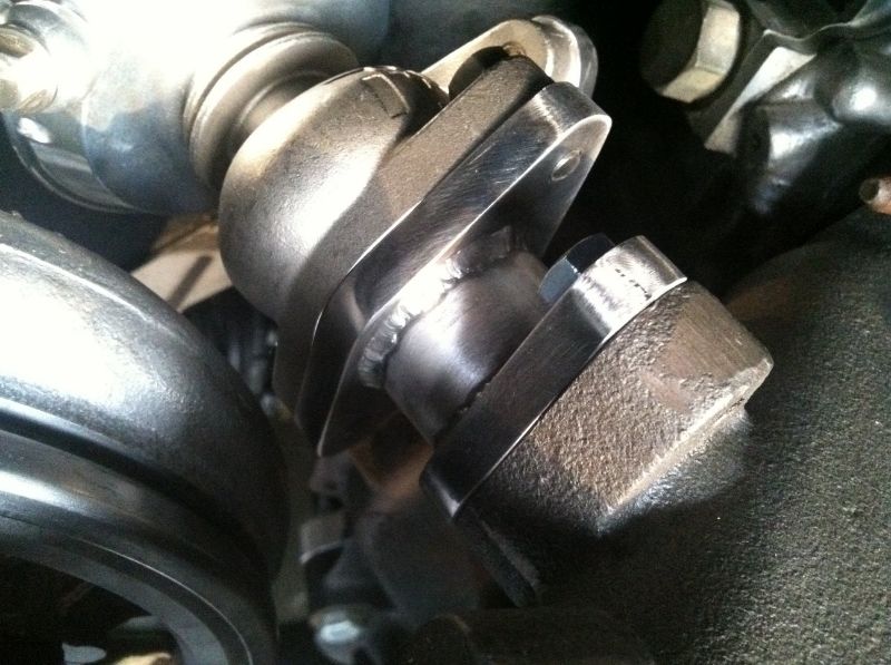

What we've come up with for one spot on the coolant system to replace the t stat housing. This is going to upper radiator. uses a standard chevy thermostat

Here's my concoction for the upper radiator hose. I just made a billet flange and ran a super tight 90 to avoid cutting into the rear suspension brace. I need to cut this down and clean it up once the lower hose is fitted as its kinda ugly haha
Here's the tstat setup. Need to add a bracket as well as a bung for coolant to the head and ecu temp sensor bung.

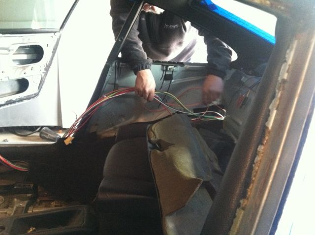

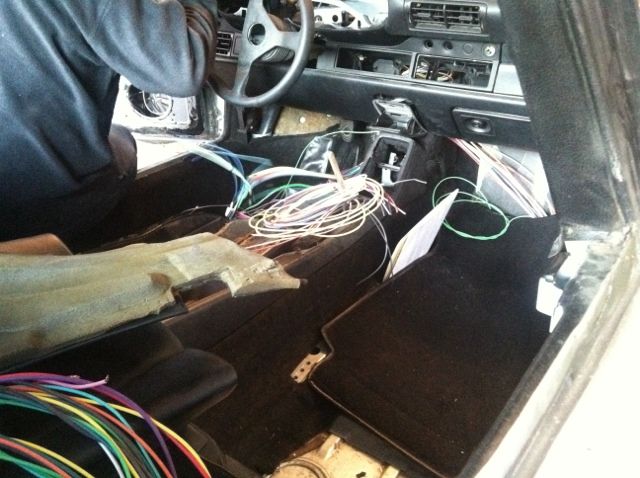

excited to finally see wires in the car

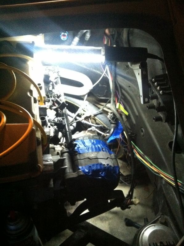

heres some things ive been finishing.

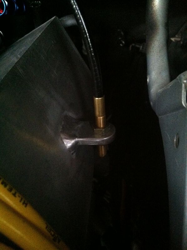

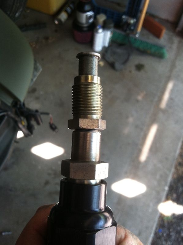

throttle cable. i had pegasus racing send me a sheath plus 4ft from the oem cable and then 144" of cable so i could run the cable just like factory thru the floor tube. since nobody makes a metric end we took a bolt, drilled it, crimped it and then welded the tip. fit right onto the porsche ball socket. for the rear my buddy stanley made an exact piece as the vw. this time he pulled the wire thru, melted the wire into the end and put some filler rod in there.
and i needed to add a tab
had to make this up to clear the wastegate.
decided to go ahead now and change the cooling sytem to all AN fittings

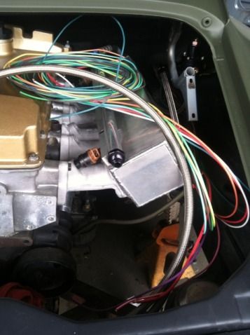

all the wiring is into the bay. ready to be plugged in. i also shaved the alternator down a fuzz as it wasnt quite hitting the intake but now its got an 1/8th.
These allow me to keep the factory fuel lines and get a leak free fit. other end is AN.
