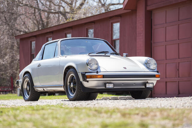

BTW - this one is interesing:
A 75 911s Targa (non-Carrera) went for $66,000!
Claimed one owner car, showing 31k mileage, but not verified by records. Silver Anniversary edition, but still -- that is all the money for a mid-year; especially for anything other than a 74 S.
Bonhams : 1975 Porsche 911S Targa Chassis no. 9115210050 Engine no. 645 0094

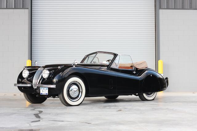

I also like this car:
http://www.bonhams.com/auctions/22717/lot/222/
It is hard to find good XK120 dropheads under $100k, this one sold at $70k. Described as a strong runner driver, and there is nothing in the pictures that stands out as negative. Maybe it is full of bondo, but that hard to hide under black paint.

Forgive me Ferry for I have sinned...
10 years ago I killed that exact same car. We purchased it down to bare metal and just rocker repairs from being ready for paint. Had a freshly rebuilt engine done by Storz with real RS P&C on Weber 40 IDS.
We stripped it. Got $10k for the engine. $2k for the gearbox. Pulled the whole interior and put it in the warehouse. The roller was sold to Renegade Hybrids for $3500. They cut it in half, put the halves on spinning rotisseries, installed radiators and an LS swap and made it part of their SEMA booth for a few years. Oh to have that car back right now...
