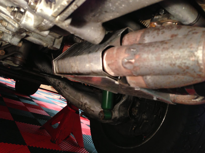

Ken's headers were Gen I units as can be seen in the top photo. The tension springs are no longer used as we found them not necessary. These headers were designed strictly for performance and heater boxes were not a consideration at that time. The boxes made for Ken have gaping holes to accommodate the springs. The Gen II heater boxes do not have these holes and are much tighter tolerance. We are now on Gen III which is a vast improvement over the originals.
Ah, yes... poor Ken! That kind of reads like it's my fault for buying your headers when I did. LOL. To be fair, I did wait three years for them but you did not charge me for the heat boxes.
I do hope to properly communicate to the next Pelicanite that might swap with me for these headers to have the facts. I don't want anyone to misunderstand the reason I'm shopping them and then get some bad karma on the board. The collector joints leak, it gets into the boxes I have (not the boxes I wish I had), and the cabin smells like exhaust under boost when the heat is on. Maybe the three way should be welded. That might do it. But the heat would always be compromised with these gaps.
Right hand side: I dremel'd off the spring hoops for clearance as advised.
Left Hand side:
Note some of the carbon soot on the box from joint:
