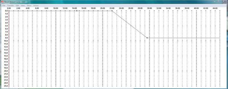

This is the boost retard curve I made the way I understand it but could be wrong.
total timing = 29 degrees
0 to 1 bar (0 to 14.7) = no retard
1 bar to 1.5 bar ( 14.7 - 22) = 0 to 0.5 bar boost - no retard
1.5 to 2 bar (22 - 29.5) = 0.5 to 1 bar boost = 9 degrees boost retard to make 20 degrees timing under 1 bar boost
Sorry for the pics, it is quite small. Photobucket is automatically shrinking it.

Is there a vac advance map function to advance timing behond WOT normally asperated timing.
That is, I am assunming the base map should be an ideal if there was no boost at WOT. (Maybe tune this map with no spring in the WG or better yet a gutted WG).
We add on top of that, retard with boost.
Can we add in advance at less than WOT at cruse?

Kieth,
There is no vacuum advance. Only retard. Therefore we will need to set the advance mechanically and then the retard will be from that point. Shouldn't be a problem as there is 25 degrees of retard possible. As I understand it the closest we get to top dead center is 2-4 degrees at start so if we have 28 degrees of advance in then 25 full retard will end with 3 degrees..

This needs to be verifited but if it only has 25 deg of advance I would probably try to start at about 7 to 10 deg at idle and let it advance to -32 to -35 and be full in in the -2500 to 4000rpm range.
Should make it peppy off the line and with near -35 on cruse and let it still get pretty good gas milage.
Then use about 15 deg of boost retard to pull it back to about -20 at .8 bar or -19 at 1 bar.
Then tune from there.

I have been thinking about this and have some thoughts.
Some are finding it an effort as to locking out the distribuitor or finding a trigger.
We are also limited to a total advance range of 25 deg when I belive we could use up to as much as 30 to 40 deg's of advance.
I am thinking we could concider wraping this thing around the existing mechanical advance system with the stock Pot retard functions disabled.
If we keep the stock mechanical advance in place we can program around this. This would give us about 15 deg of mechanical advance plus the 25 deg of MSD advance for up to a 40 deg timing range.
I think a starting point might be the following 'goals'.
-5 deg at idle quickly going to say -15 by 1500rpm.
Full advance of -35 by about 3500rpm with no boost. (Big improvement in motor temp and MPG).
-20 deg by .8 bar or -19 by 1 bar.
Thus, if the mechanical advance curve is a total of about 15 deg between 1000rpm and 3000rpm that is about 3.75 deg advance per 500rpm.
We could set up the MSD as follows.
Base map would start at idle at -13 (35 less 15, less 7 ). We will retime the motor at the pully latter.
1500rpm would be at about -9 (35 less apx 15, plus 3.75, less 15)
From 1500 to 3500 it would go from -9 at 1500 of base retard to 0 retard at say 3500rpm.
That would be the base map starting point.
Then boost retard map would need to be programed to able to retard from -35 total advance to -19 at 1 bar boost.
This would probably taper from a maifold pressure 15 being 0 retard and a straight line to 16 deg of retard (35 less 19) by a maniflod pressure of 30. It could continue to retard further at higher boost. We could even get more agressive at higher boost levels as a soft boost limiter.
With these programed in, we would then have to retime the ditribuitor using a timing light.
We would have to mesure off a timing mark on the pully to -35 degs.
Then timing would be set at -35 at 4000rpm with the vac line to the MAP sensor dissonected. This might require moving the distribuitor indexing one tooth.
Then with the MAP sensor hooked back up we should hit our stated timing goals and then further fine tuning can be done from there.
