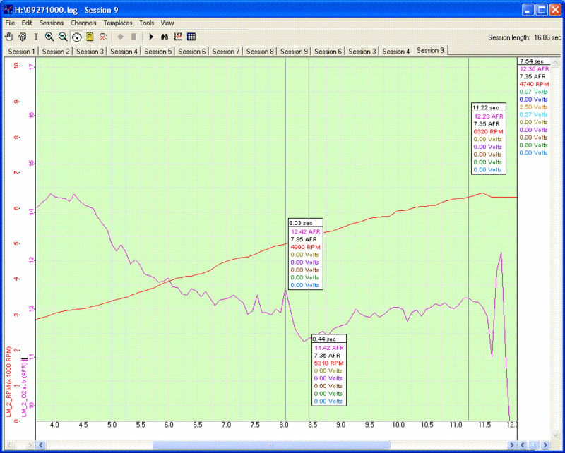

So my LM-1 broke and I did not want to ship it back to innovate on my dime for repair so I bought a LM-2 dual sensor. However it does not work good in a 930 from a cigarette lighter (AFR jumping and freezing). Then yesterday I rigged up a separate power supply cord from a broken PC-power unit and it now has a diode and a capasitor to help the voltage drops of the old 930 elec. system.
Only one freeze of the LM-2 lambda output in two hours is pretty good. IMO the quality control of innovate has gone to sink!
So this is how the AFR is now. I have extra fuel from 5000 rpms on and it seems to be pretty good. Colder weather made me dial the idle a bit richer so it's now at around 13.7 again. Cruise is around 14.7-15.3 which works just fine and the consumption is decent also. With this tank I have done 3/4 and about 300 miles while cruising plus twisty back roads.
Here is 3rd gear WOT from today

Good work. Looks like you are up and running.
Are you running a frequency valve bypass around the WUR or controlling the Lambda FV?
Went back through the posts and I did disable my boost enrichment vac line to the WUR and used the FV-bypass for on boost control.
I also left my AIC in the motor compartment and attached it to the manfold.
I see you have a lean surge with acceleration. I do not think you can totally get rid of that. I was able to make it very minimal by dropping control pressure to a min with first throttle and bringing it back in support of my goal AFR. Might be able to do so via the Lambda FV if you are taking control if it.
Best of luck.

The setup is like I told before in this thread: AIC and valve (injector) at the lambda port and BLwur boost line disconnected.
I don't think that lean surge is that bad but maybe later I will try to dial some of it out with more fuel on vacuum cells?
