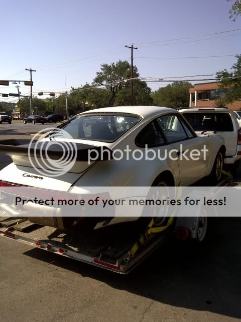

Introducing #100. My first "real" 930
I got my first "real" 930. It's a 78 RoW car and # 100 produced. I have the stock parts, but got some go fast goodies with it; SC cams, K27 HF turbo, GHL headers, 46mm tial waste gate, and an aftermarket intercooler(Garrett or Kokeln?) A PO put the "Carrera" badging on. I have all the skirting and euro bumper. I think I will leave the rocker panel covers off though. I like it.

John stopped by the house last night so that he didn't have to tow home in traffic.
I got the first view at #100. RoW. non-sunroof. sport seats. clean, straight body, decent paint. A price that makes a friend jealous. What could be better?
Next step is to get the front and rear valence in place, check AFRs with the LM1, make tuning adjustments as necessary and then enjoy the car. Its a fantastic driver.

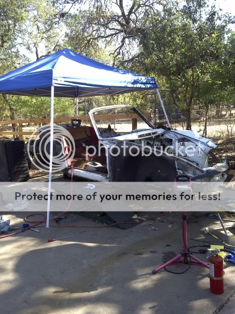

Well that came apart pretty easy.
Just kidding... That's the 86 that just got finished stripping.
