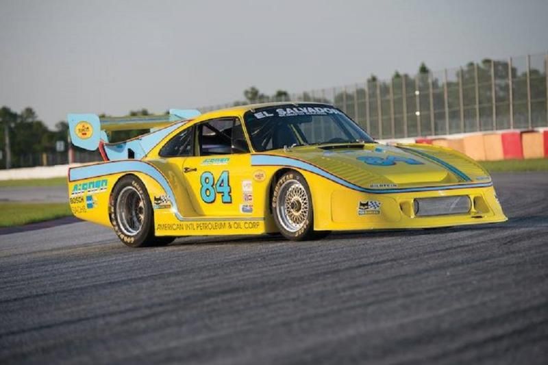

Jerry Woods makes a billet sump plate that I run on a few of my 935's.
Unfortunately you cant see the sump plate but you cans see I have hard lines from my turbo going to a section of flex hose to the sump plate
http://img.photobucket.com/albums/v6...r/a1a80fcd.jpg
Can see a little of it in this shot
http://img.photobucket.com/albums/v6...o/2caacb50.jpg

VZ935 11-03-2014 04:02 AM

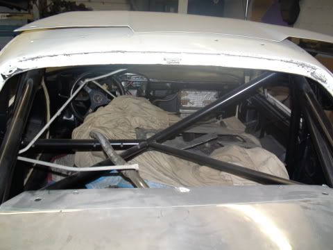

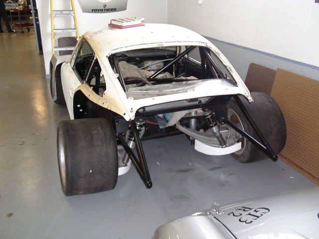

At WEVO we started with this and boxes of parts...
http://img.photobucket.com/albums/v6...O/DSC00421.jpg
http://img.photobucket.com/albums/v6...O/6ca6052c.jpg
And just like the movie , 9 1/2 weeks later we ended up with what you see above. Finished the car at 7 AM , loaded it on a trailer and I made it in time for the second practice session at the Monterey Historics IMSA/GT Group.
