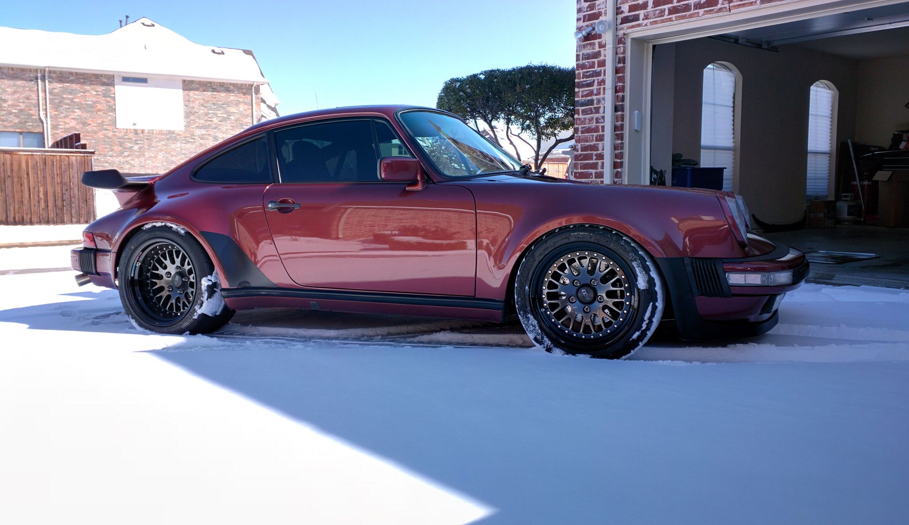

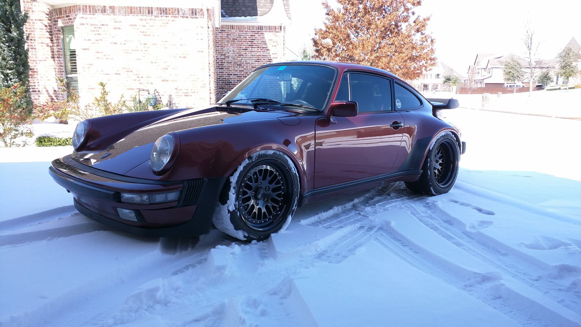

My car is set at -1.5 degree camber front, 7 degrees caster, 1/32nd toe in. Rear is set for -2.8 degrees camber and 1/16th toe in. My cross balance is pretty close to your and was set with 200lbs ballast on the driver seat. My car's weight was 2,694lb IIRC and add my ballast to 2,894.
We were shooting to get around -2.5 degrees on the rear but couldn't get there at my ride height.
Wheels are 9" +30et fronts with 255's and 11.5" +0et rears with 315's.
Ride height... Well... I think like 24.5"?

it's not exactly like raising it up from where yer currently at is going to result in Ranchoness
yesterday:
and that's with me bumping the nose up by a C-hair (redheaded) with the torsion adjuster because I was getting some tire rub under compression with my instructor onboard @ MMC
