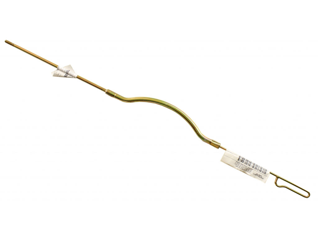

Help needed-missing accelerator linkage
I'm rebuilding a 1986 3.3 turbo motor I bought off Craigslist disassembled in early 90's. Missing is the accelerator link between the gearbox bell crank and the bellcrank on the engine. If you have a picture of the part, I'd really appreciate you posting it. If you have one for sale - that would we even better!
Thank you in advance!

linkage
I traced this pic of the linkage from my 87 on my work table... I had to bend it, and wanted a memory of the original shape. In a couple of weeks I'm going to drop my engine, and if you needed a better pic I can send you one. Philip

Thank you, Phillip.
Now at least I know what to search for

I needed one. Either Porsche dealer parts dept, maybe it was Porshe classic @ PCNA or Pelican parts is where I found a new one. Around $100.00 about 2 years ago.

The hump lets it clear the drive axle.
Still available from Porsche.

From the 1986 USA parts catalog it appears the part number is 930 423 019 02. It appears our host has them available.
