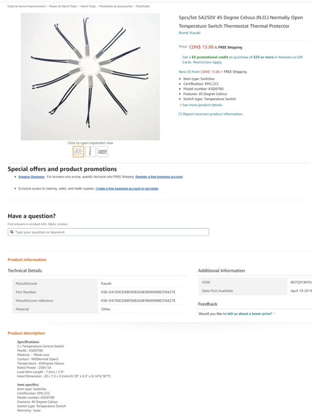

Hello,
I could sure use some help. My 35DegC switch on my 81 911SC is broken. It is unavailable and is not superceeded. It is part number 93060611701, normally open and it closes above 35DegC. It is located on the crankcase breather lid.
Would someone be able to test or knows if 93060611703 is also a normally open switch?
The only hint I have that it is instead normally closed comes from the following link, but it is not necessarily correct as I don't know if the schematic is the right one.
http://forums.pelicanparts.com/porsche-911-technical-forum/951491-anyone-know-how-these-temp-switches-work.html
I can pick up a 93060611703 switch rebranded as TS-482 and others. I've contacted the distributors, spoke with their parts people, but they have to order the parts in and have no data at all on it.
Please let me know,
thank you,
Phil

Hi San,
Thank you for that, Is this a normally open switch? (open when below 35C)
I ended up cutting off the top, removing the internals and replacing them with a 45Deg normally open switch rated to an even higher operating max temperature and sealing back up. I called every distrubtor, napa store etc.. and they couldn't tell me if the switch you are holding was N/O or N/C, so this is one of the few areas I improvised, but I tested the switch that I "modded" in H20, just fine. But if this is the switch that you can buy at R/Auto and other places online, then wow! You'll save the next guy from underriching and then overrching (perhaps?) the mixture over operating temperatures, but only if it's N/O.
Actually, I just noticed the porsche logo, where did you buy it from? Does it have a part number? ..
Phil
Old 12-10-2020, 06:33 AM
Join Date: Oct 2019
Location: Ottawa
Posts: 725
I stuffed this inside the old shell of the original sensor. Made sure that common was the outside of the new sensor and removed it's outer silicone sleeve. Shaved the edges down a bit, pushed it in and siliconed up the top, one wire soldered to a connector fitting, the other, common went back to the a nut on the breather cover to common/ground. 5A part, can't remember but found the max operating temp was around 150C.
Phil

Location: Ottawa
Posts: 725
Problem was, Porsche doesn't sell this one anymore, there is a normally closed 35 switch they sell, but that would enrichen the mixture when it should be leaning and vice versa above and below 35. Maybe better off just grounding it then, don't know. I tried to find a similar switch with reasonable max operating temperature, I think there was a 70C switch, right footprint for furnaces or something, same company that manufactured the porsche one, but 70C was a little too far from 35C for my liking. R/Auto and some other retailers sell a switch that is 35C for a reasonable price, but they won't tell you if it's N/O, so I called their distributor who said they didn't have any on hand for the engineer to measure, and so on. So I just went with the 45DegC solution, the sensor I've shown fits right into the lower end of the tube, nice and snug so it's naturally grounded to it's outer shell. So it works out pretty good. I tested around 3 of them, they vary in on/off by probably +/- 5 degree and some variation in hystersesis, so test them first. I'd like to hear from someone who knows where to source the original style, like from the sellers I've mentioned and tell us if they are indeed N/O switches, that would help out the next gen of 911 builders.
Phil

Join Date: Oct 2019
Location: Ottawa
Posts: 725
Solution is still working fine. I get 75% off idle enrichment when cold. 35 or 45 degrees makes no difference, but there is a wide array of temperatures to choose from.
Again, as written above, I cut open the old sensor and stuffed an amazon sensor inside the shell (dremelled the new sensor a little on the edges so it would slide in snug), siliconed up the top and what can I say, nothing to it. Only make sure sure that the case of the sensor is ground. Some sensors have isolated outer cases, some don't.
81 SC.
