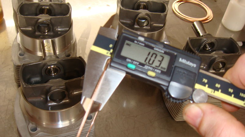

so i get all of the pistons assembled to install on the short block. i only install the inside circlip for now because after checking clearances i will completely disassemble and wash everything.
always use a liberal amount of engine oil on your cylinders.
i measure every single part of the engine to make sure both banks will line up and not bind the cam housings. you can see i measured each base shim to be the same thickness.
