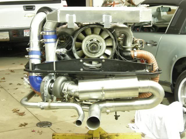

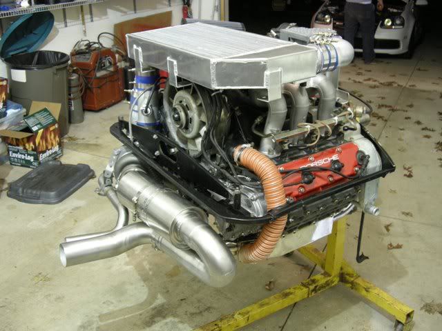

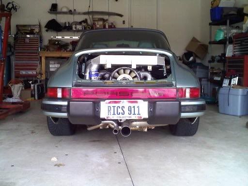

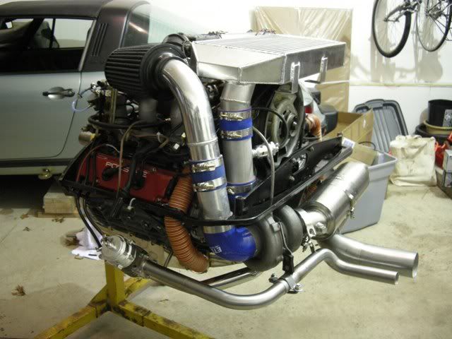

Rick Chip III 11-16-2009 06:18 AM
Pictures of the final product...
http://i260.photobucket.com/albums/i...a/DSCN0489.jpg
http://i260.photobucket.com/albums/i...a/DSCN0490.jpg
http://i260.photobucket.com/albums/i...a/DSCN0491.jpg
http://i260.photobucket.com/albums/i...10088_3036.jpg
RarlyL8 11-16-2009 05:49 PM
Damn Rick that's nuts!
sjf911 11-16-2009 07:52 PM
Beautiful! Good job.
A couple of questions. Are those GSF headers and IC? How are you handling the turbo oil return? Also, I thought the C2 gaskets were cut into the cylinders, is there another type? How much advance are you running?
lane912 11-16-2009 08:03 PM
i want to put one of those in my 66' 912 for a conversion!!!!!!
that is awful perty, good job
Rick Chip 11-17-2009 03:34 AM
Thanks Brian - the exhaust is really sweet
The headers and IC are both from GSF.
Turbo oil return is going to the oil drain plug on the bottom of the case
C2 turbo gasket are not cut into the cylinders
Timing is handled by the Protomotive chip you would have to ask Todd Knighton
Thanks for the comments.

Rick Chip 05-30-2010 06:40 PM
Hey 911st,
I have just had the valves adjusted at 1000 miles. After that I found out I have a miss at full throttle above 5000 rpm and I am trying to figure out what it is. I am going to pressureize the intake system and see if I have any leaks. I installed a 044 Bosch fuel pump so I do not think it is lack of fuel. Still trouble shooting.
Up to 5000 rpm the power is very intense.
Thanks,
911st 05-31-2010 07:55 AM
Such a nice job and clean install.
I like how the IC is a bit to the right to make room for the air filter.
Can who ever fabed the IC and snorkel reproduce thouse easly if some one wnated one?
I assunm you have a wide band on it. Is that telling you anything?
Did you go to 944T injectors?
Could your injectors be going on you at the higher pressure?
The best!!!
Rick Chip 05-31-2010 02:59 PM
911st
I fabbed up the intake out of 3" aluminum, i can give you a drawing of what i did if you like.
The vertical stack from the turbo to the intercooler is a GFS part as is the intercooler
No, I do not have a wide band on it yet.
The chip is programed for stock injectors, they are original and were fine, they may be the problem
Thanks,
