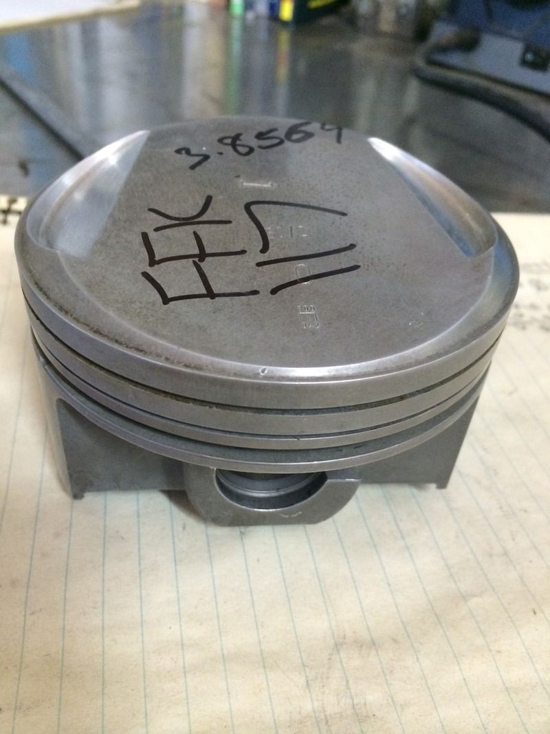

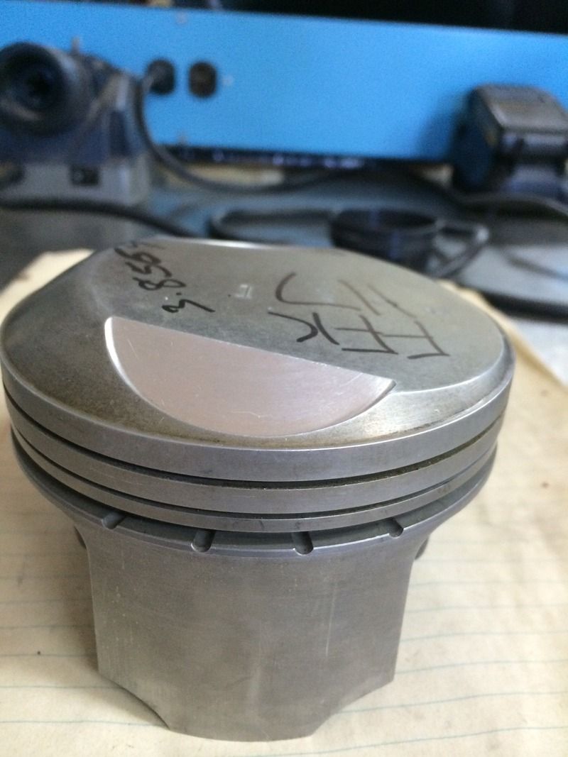

Old 08-02-2015, 08:49 AM
Josh D's Avatar
Join Date: Apr 2011
Location: Gilbert, AZ
Posts: 1,573
Here's pictures of my 98mm 3.0 to 3.2 pistons. If you look at the short side of the dome, it's clear that it is shorter than the short side of the 3.2 to 3.4 pistons you have. That's a pretty good indication the 3.4 pistons are the ones with the greater dome volume and higher compression.
My best guess would be that the 3.4 had the higher 9.8:1 ratio due to the Motronic having spark control in it's mapping and could handle the higher comp ratio. The lower 9.3:1 3.0 to 3.2 where originally developed for the low compression (8.5:1) big port Euro spec engines that didn't have spark control, but had a richer tuned CIS. It could only handle a modest increase in comp ratio without spark control when ran on premium fuel and an adjustment of the CIS to run a bit richer. That's my guess anyway.
I'll be curious what info you get from Mahle.

Old 08-03-2015, 07:41 AM
gliding_serpent's Avatar
Join Date: Oct 2011
Location: Nova Scotia, Canada
Posts: 2,151
JoshD, thanks for those photos!!! You basically answered my question then. Makes sense, and it means my comp ratio should be near bang on! I will await word from mahle before anouncing it to the world.
Thanks again!

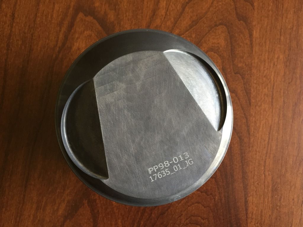

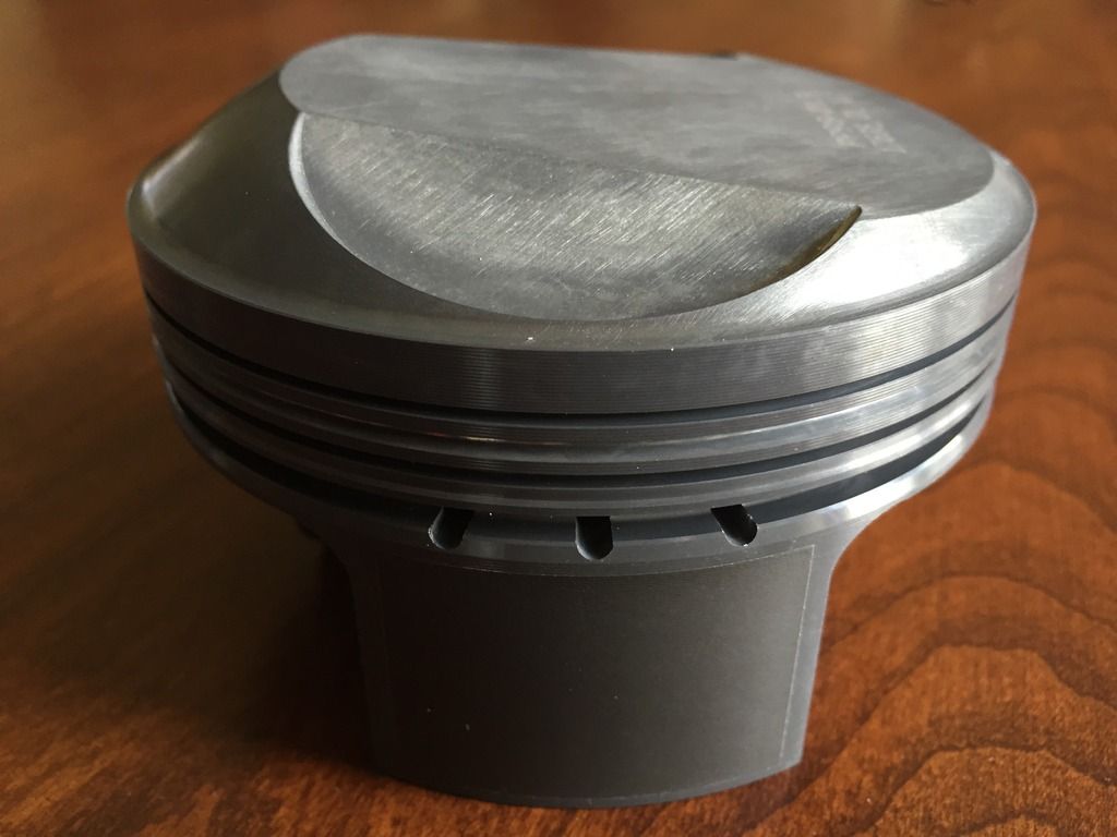

So here is the response from Mahle. They gave me the run around at first, saying i needed to give them a parts number... Which i did, each time. Here is their response:
"Called Motorsports for you this morning & confirmed part # & specifications for you. Compression height is 32.8mm. & volume is 35.4cc & this is based on the 3.2 to 3.4 application. The actual part # is PP98-013"
So my compression ratio is spot on!!
