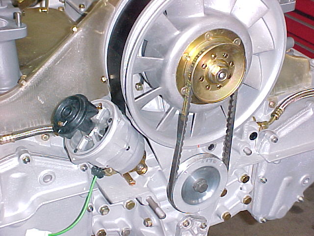

Another couple pictures showing the fan belt. Note the twist in the belt in the second pic due to the pulley arrangement.

From what I've read, by manufacturers of flat fans, that they are useful (needed was their word) over 700 hp.
I'm not sure I would trust a 90 degree fan belt like above on a high stressed turbo charged race machine or trust some home brewed flat fan shroud to distribute the air evenly. The last the entire reason for using a flat fan, except for the cool look!
The Chevrolet Corvair ran their cooling fan that way.

Does any one know the effective diameter of the pulleys?
I think it is convention to take the inner diameter and add the extra size for the neutral axis of the belt which is at around 1/3 of its depth.
This would mean the following:
65-73 Crank Pulley 98mm Fan Pulley 69mm Ratio 1.4:1 At engine speed of 6000rpm the fan would be 8400rpm
73- onwards Crank Pulley 108mm Fan Pulley 59mm Ratio 1.83 At engine speed of 6000rpm the fan would be 10800rpm
If you mix them up the following occurs:
65-73 Crank Pulley and 73 onward fan pulley the ratio is 1.66 so the fan is faster than with its original fan pulley but slower than the later set up.
73 onwards crank pulley and 65-75 fan pulley the ratio is 1.58 which is slower than with the original pulley.
It seems that you can't speed up the later fan without making a custom fan pulley and this may be an issue for the belt as reducing the diameter will cause more fatigue damage and could reduce belt life.
If there is no room to increase the crank pulley then the solution would become complex.
