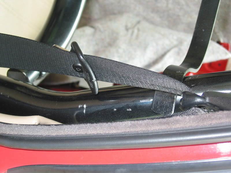

Does anyone have any insight or pictures on the best mounting position for the shoulder belts of a 5 point harness in a E30?
Does anyone have an Autopower rollbar in their car as well?

Does your autopower roll bar have a diagonal and a shoulder harness horizontal bar? By your asking the Q I am guessing not. I would suggest adding one to the bar so that the harnesses are mounted right behind you seat (on the bar). Also allows you to add a seat back brace which many racing organizations (club or otherwise) require. Do both with one modification.
It is the best setup for safety and should you ever get a HANS device, include loops on the shoulder harness bar that are close together. Meaning, guide loops for the shoulder harnesses (or where they'll wrap around the bar itself that prevents them from spreading apart (crucial to making a HANS sork correctly).

I am building an e 30 DE car..... just instlld AP 4 pt bolt in...nice fit but not great( maybe 2 finger space bet top hoop and roof)..other wise its good for 400 bucks....VSR fits better and Kirk is just as good...... w/ a harness bar the shoulder belts just wrap around.......

As far as the shoulder belts go, a BMW DE friend with an E30 325is Hotrod runs his five point belts back to the rear seat belts. Not sure if he runs a harness bar or not, but something tells me not. I can email him for more info and pics if you like.

fit is good for the price. VSR may fit better. For 5 pt: use oe outboard holes frm stock seat belt, inboard many drill holes into tranny tunnel and use eye bolts. For stock seats many just run lap belt over front of seat bottom but thats not so great....
