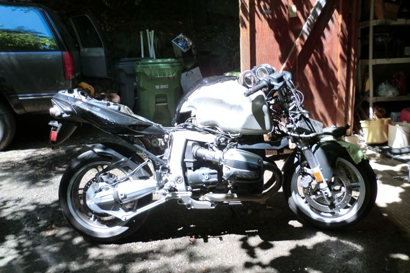

So I've noticed a little 'looseness' up front recently (past few weeks), mainly while railing through the curvy mountain roads. I thought it was my POS leaky front shock, so I've laid off on the wheelstands as of late. Then one day I noticed the whole fairing/instrument cluster oscillating as I was leaned over on the local roads!
A little disassembly was VERY revealing:

So I was facing a major double-displacement:
bad frame out-of-place, and bad ME out-of-hammock-on-a-holiday.

So on Tuesday I stopped into my local specialist welder- a guy whose name was passed on to me through another biker buddy. The welder shop is in an unmarked old warehouse, no signage anywhere, no hours posted, no phone # to call and see if anybody is in. Last time I went by 4 times before I got someone!
Well, he was in when I showed up, fixed it in 15 minutes while I waited (including adding some extra welds to stiffen up other suspect areas)- and the whole shebangabang only cost me $20.00! This guy's a stud!
I told him I'll break something else just as soon as I can just to come back and watch him do his magic.

I kindof like the streetfighter look!

you need to stop chopping the throttle and get softer landings.

I'm SURE that the frame is broken due to wheelies- and the associated learning curve.
At first I would get the wheel up and get excited and *chop* the throttle, slamming the front end pretty hard. I soon realized that this could not be a good thing for the front end, so I began to actually try to wheelie with some technique: slip the clutch in 1st to get it partway up, then hit the fat part of the powerband to gently lift the front all the way..... as soon as the power starts to taper, clutchless shift into 2nd and run out the throttle until the nose gently comes back down. I've gotten it into 3rd a couple times!

I hate that front headlight/cluster frame.
It's a total PITA to remove/replace what with the way the fuseboxes and electrics are intertwined with it and it bends like putty in any kind of wreck. I managed to straighten mine after a minor shunt, but it never has been exactly right since and because so many things attach to it, the bodywork doesn't quite line up correctly despite repeated re-aligns. It's ridiculously expensive to replace and even new ones are so soft, they likely are tweaked form sitting around and shipping.
