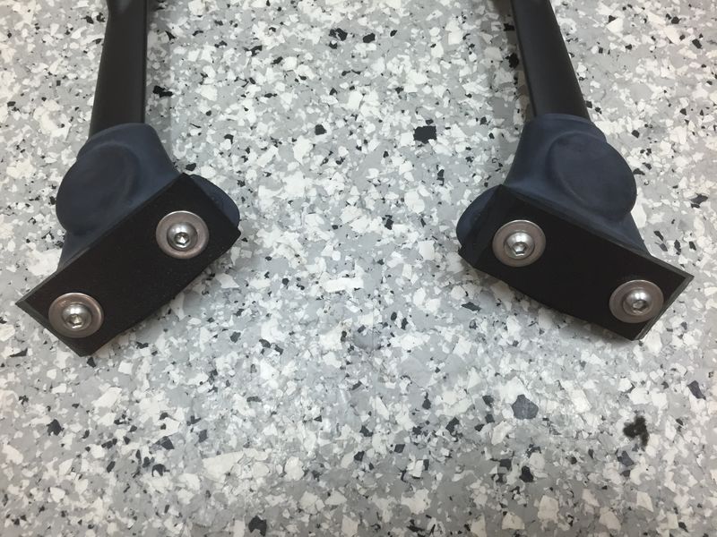

F/S HP2 Sport / S1000 Mirror Conversion Kit
Up for sale is the last pair of S1000 mirror conversion kit that I made. As some are aware several years ago I developed a direct bolt on kit to install the S1000 mirrors on the HP2 Sport with no modifications to the fairing. Offers greatly increased visibility and looks factory. $250 delivered in the US.

Is there somewhere where this can still be purchased?

No, but what someone has done of Fbook is just use the S1000RR mirrors without Eric's adapter.
You need to purchase S1000RR mirrors, cut off the mounts and then drill to match the holes in the HP2 fairing. You also need to make a backing plate and get the appropriate nuts/bolts/washers to bolt it all together.
