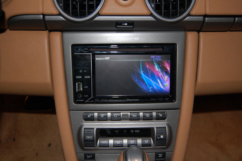

Thanks George. Any chance you could upload a photo with your new stereo unit?
Regards,
Jay
P.S. BTW Don I apologize for intruding..
Sorry, missed this. I posted pix in another thread, but here you go:
George

George looks excellent! Will probably do the same.. Thanks.

Slight Adjustment
Hi George,
I came across your picture while doing a search on Google. I wanted to take the time to help you improve the look of the install even further.
From the angle the picture was taken, it appears the bezel is not flush with the to top edge of the climate control on the right hand side. What this appears to be is the the mounting clips are not completely in position. The aluminum tabs on the back of the bezel is notched out to lock the mounting clips in place. You simply need to take a very small flat screw driver (we recommend taping it up to avoid marring the paint surface) and press from the top of the bezel so that the mounting clips will properly lock in place. Doing so, will allow the bezel to sit flat with the climate control unit below.
Apart from that, congrats on your clean install.
The picture attached will help you better understand how the parts come together.
Cheers,
Loi

Thanks Loi--appreciate it. After looking at the picture when I posted it, I noticed it as well. I simply didn't have it placed properly and subsequently fixed it with a small push.
I looks great and I appreciate all your help on the install!
