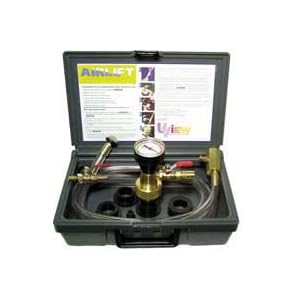

You obviously have trapped air in the system from draining the coolant. By far, the best way to prevent that is by use of a vacuum filling system (Uview's system is a good example) which totally eliminates any chance for trapped air in the system.

You are most likely getting air entrapped in the system, which can cause steam pockets to form, which can do significant damage. The all alloy M96/87 do not like to be overheated. Because of the layout of the cooling system, air can easily get trapped in the engine or radiators, and lead to big problems if not removed.
There are two ways that these cars are supposed to be drained and refilled. The first (and preferred) method uses a vacuum filling system that totally prevents air from entering the system, and refills the car in only a couple of min. The second method involves “burping” the car using the vent valve next to the surge tank in the boot. This is more time consuming, and often has to be done multiple times to get the air out. Do a search for this method; it has been covered several times.
