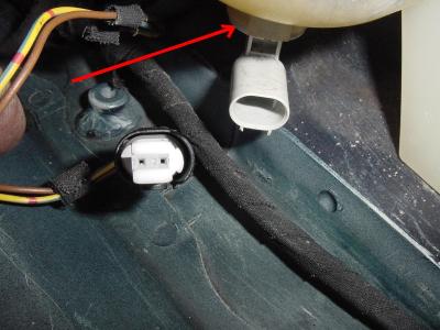

Well, as no one took my clue and searched for the reasons why the light might be blinking, I'll do it for you:
Four functions of the coolant warning light:
1. Engine coolant level too low
— light flashes slowly (0.5 Hz)
2. Engine compartment temperature too high
— light flashes slowly (0.5 Hz) (engine compartment blower might be faulty)
3. Engine coolant temperature too high
— light is lit; pointer on the right
4. Temperature sensor at water outlet faulty
— light flashes rapidly (1 Hz); pointer on the right
Note
The temperature warning in point three is indicated if the conditions "engine coolant temperature too high" and "engine coolant level too low" are present simultaneously
(1Hz = 1 flash per second. 0.5Hz = 2 seconds per flash)
So it might be the coolant level sensor is faulty (if the light is slowly flashing). If it is, you do not need to remove the tank to replace it:

Here we go again. Light still flashing slowly. Replaced low coolant sensor twice now. Checked wiring. Engine compartment fan works properly. So I am assuming the temp sensor is functioning. I also checked to make sure the temp sensor in the engine compartment was not displaced and appears to be mounted securely between the 2 intake runners. Coolant reads in between max and min whne COLD. Low coolant light blinks slowly even when car is COLD.
The new expansion tank I purchased is aftermarket and wondering if this is the issue. If you peak down the fill spout there is a slight difference between the new and old tank. The old tank has a cap on the area that I would assume is the float for thew level sensor. The new tank is slightly different and does not appear to have the same cap on it.
Thoughts- Maybe a faulty tank?
If I drop a wire down into the tank and pull up on the "Float" should the blinking light go out- assuming a running engine?
Could I take the old tank and plug the hole(s) so it retains water, set it next to the new tank and plug in the to the sensor could I "test the Tank?
Other option is to try replacing the engine compartment temp sensor but all appears to be functioning in there.
Any help is greatly appreciated, I just don't like driving around with this stupid light flashing although there does not seem to be any temperature issues at this time.
