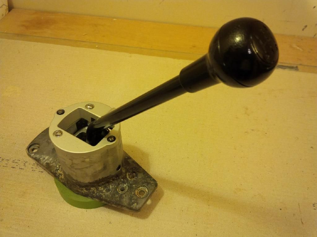

Not a big project, but something I can do partially indoors...
WEVO Classic shifter plus a genuine (old) 915 shift knob
1980 911SC Targa
