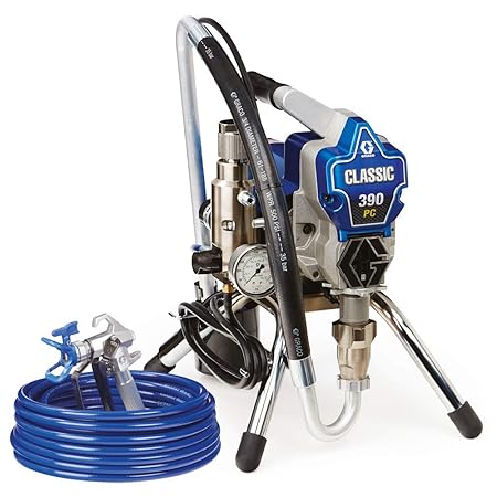

Most professional painting contractors I know nowadays use electric spray machines more like this one:
