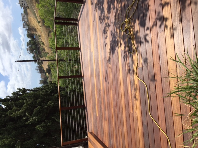

We installed an upper deck out of TimberTech AZEK Kach suggested. Its ok, but not my cup of tea. I dislike plastic. They feel like P lam or Pergo floor to me. Its been OK so far.
For lumber, I really like Ipe. Absolutely bullet proof. Fire rated too. 5/4 would be my suggestion.

Did the deck for my neighbor a couple door from me out of Mangaris. Very similar to Ipe, but not as dark and dense. They are all pretty tough lumber and very decay resistant. Love those wood deck. You gotta maintain it once every couple of years. I have not done any maintenance to my own ipe deck in about 10 years. Its been fine, no issues. a little cleaning or oil, its good as new.
