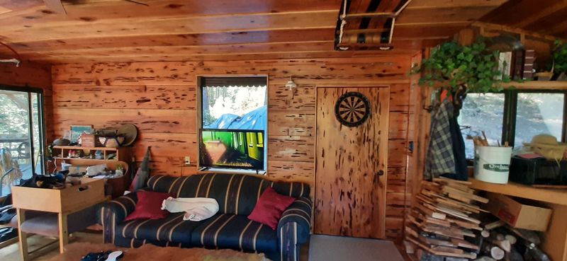

Thanks! The only real skills involved with the ceiling were avoiding disaster. Fastening 13" wide 15 ' long boards by myself took a bit of figuring out but disaster was avoided. The walls will be Pecky Cedar as you can see in this pic. No candles allowed in the cabin!
Ceiling battens were glued and pin nailed on one side only to allow for expansion/contraction of the wide boards
http://forums.pelicanparts.com/uploa...1696100582.jpg
Capped my solid core entry door with the ⅞ Pecky Cedar. A very heavy door now. Struggled with a hand truck to get it back in the cabin then had to use a crow bar and block to lift it back on the hinges

Jeez, 7/8" anything is heavy. I imagine cedar is probably lighter than a lot of other stuff, but still. Hinge upgrade?
Looks great!
