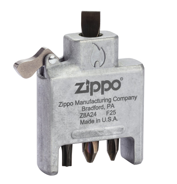

Not sure where to put this...
I think these would make good stocking stuffers
Zippo Bit Safe
https://zippo.com/cdn/shop/files/ejj...8715&width=600

That's kind of cool. I don't smoke and have never carried a zippo, but my parents did. I've got a bunch of old zippos that were my dads that commemorate various things.

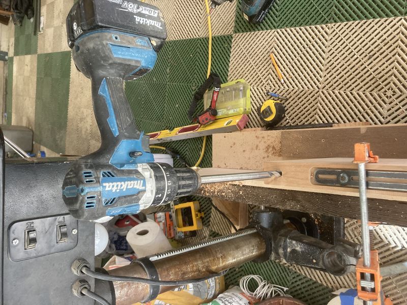

Drilling floating shelves for under cabinet lightinghttp://forums.pelicanparts.com/uploa...1761871771.jpg
Build a jig
http://forums.pelicanparts.com/uploa...1761871920.jpg
Start hope with drill press for perfectly straight holehttp://forums.pelicanparts.com/uploa...1761872010.jpg
Finish hole with 12” drill bit http://forums.pelicanparts.com/uploa...1761872126.jpg
Drill connecting hole from routered channel.
