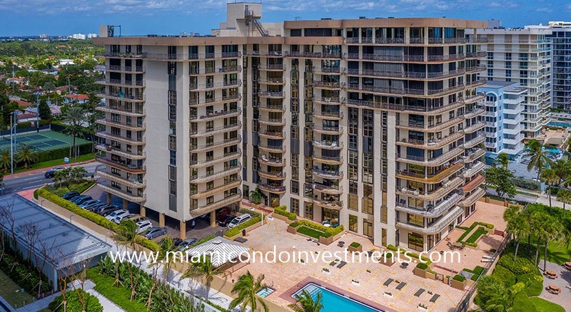

LEAKYSEALS951 06-28-2021 11:05 AM
Found some pics pre collapse of the patio/upper parking. Using Dad911's "champlain towers south" blueprint title leads to some pics of the place in better times. Interiors were pretty snazzy.
https://www.miamicondoinvestments.com/champlain-towers-south-condos
