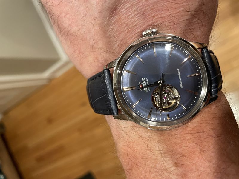

Very nice watches for the money. I picked up this Bambino open heart a few years ago.

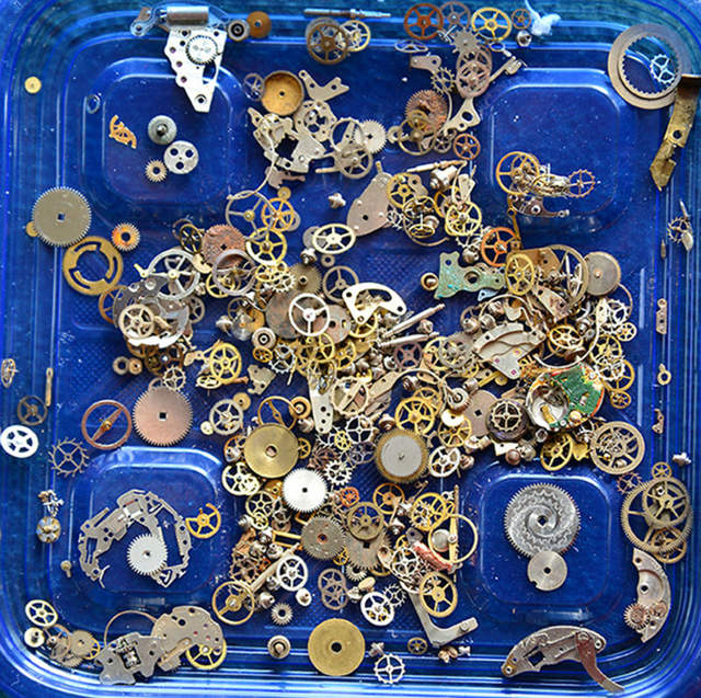

Wasn't it WDfifteen that had the "watch" dog where he covered a dog figurine with watch parts?
Yes, Salvador Dogi, our watch dog.
