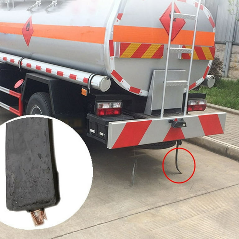

If you have been on the planet for a while, you can remember when cars trucks and especially cop cars had two straps hanging down from the back touching the road.
Now I know fuel trks use specially made tires to ground to the road, and aircraft hook a ground up B4 fueling.
That is understandable.
But back in the day, lots of cars dragged straps.
Now do I need little steel taps for the shoes I wear....remember those?
Or more importantly, do I need ground straps?
Next month we can discuss why flat ground straps are used.

Ground straps were to stop static electricity. I need them for my truck. Winter time it shocks the crap out of me when I get out.

I still have a couple of those in an old box somewhere. My dad always had those on his cars when I was a kid. Supposed to be for static electricity, so you didn't get zapped when you touched the door handle.

Now I know fuel trks use specially made tires to ground to the road...
Huh, I just learned something new. Could you please explain how these work? I'd think, being rubber, they wouldn't provide any ground.

Many fires were started in dry areas from the sparks from the metal ground straps.
The only time I get shocked is getting out of my Velour seats in the El Camino. I learned long long ago too use the key I just pulled from the ignition to touch the door lock knob. The spark jumps from the key to the lock knob before I touch it. No more static and I feel no shock.
"rubber" as you get it from a petro-plant or from a tree is an insulator. It's also kind of crap on its own for tires, so for that and other reasons we load it with carbon black (basically soot). Hence your black tires. It's better for its use and a little more electrically conductive. Now, load it with more conductive things and you can dissipate the static charge. No charge buildup = no electrical sparks.
In some workplaces that really, really care about static electricity - like with flammable liquids/gasses and propellants/explosives - you wear dissipative footwear and even make sure that your "rubber" tired furniture conducts enough electricity to the floor so as to prevent a charge buildup.
I've been places where you had to stand on a mat and get measured - if you weren't dissipative enough (i.e. "grounded") you couldn't even insert your access card to open the door.
And, now thinking about this, I finally understand why lots of vehicles like ambulances might have loose chains dangling and jingling. Thank you! Now I realize that I kind of knew but didn't really ponder it...
In addition to dangerous situations (around inflammable explosive materials) working with sensitive electronics often also has a requirement for folks to be grounded (wrist straps, mats to stand on, etc...).
