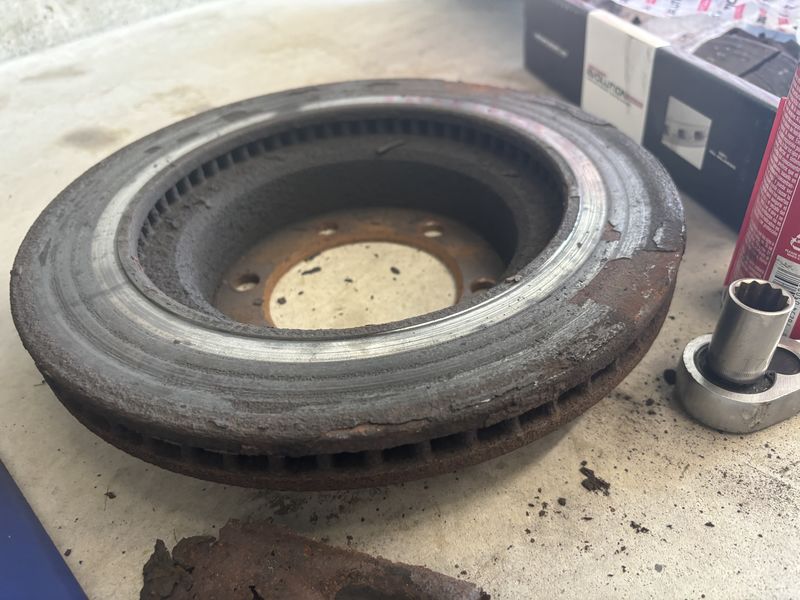

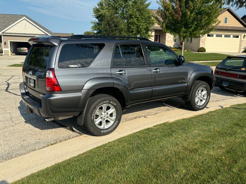

Been working on the kid's '07 4Runner this week (getting ready to head off to college).
It has 242,000 on the clock. Runs/drives really nice. I'd drive it pretty much anywhere.
And it's been a WI vehicle since new. Some surface rust on the frame - but there are some out there that are pretty bad.
This week was all the driveline fluids (had a pretty tight front diff plug. Needed to go get a set of EZ out's and use some heat to get it out). Recently did accessory belt and idlers along with water pump.

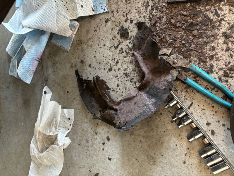

Also did the front brakes yesterday. I think the dust shields had been dissolving for a while - as the inside pad and rotor face had some serious issues - but it drove and braked like no problems.
(The dust shields are gone now... I would replace - but that brings along the issue of needing to replace the wheel bearings.)
All in, it's been a great vehicle. We picked it up from original owner with 224,000
