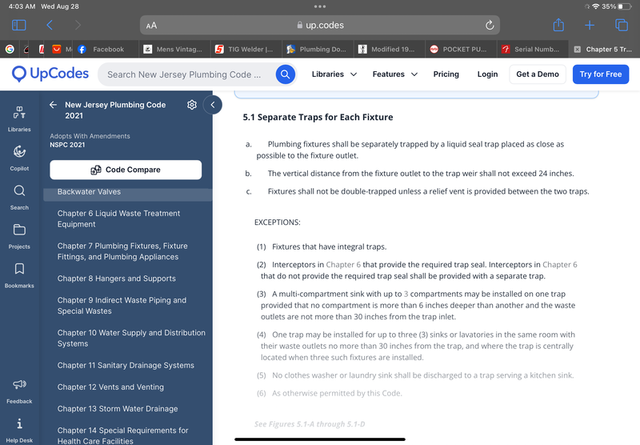

Oregon Plumbing Code permits two sinks on one trap, with conditions
"One trap shall be permitted to serve a set of not more than three single compartment sinks or laundry tubs of the same depth or three lavatories immediately adjacent to each other and in the same room where the waste outlets are not more than 30 inches (762 mm) apart, and the trap is centrally located where three compartments are installed."

As I suspected from the NJ plumbing code of 2021…
One trap for a multi compartment sink is allowed… (exception 3) but it is a ‘May’ not a ‘shall’. This means you can do one trap per sink compartment or one trap for both.
What is NOT allowed is putting 2 traps in series (one after another) without a vent between them (5.1c).
Read the code in your jurisdiction, be mindful of the ‘shalls’, ‘Mays’, and ‘musts’…

Posts: 8,834
Double p- traps are against code here in NJ
See my post above…

That screen capture is the NJ code. Double p-traps are NOT against code in NJ (unless you meant connecting 2 traps in series).

That is what I'm talking about. Because one will draw the water out of the other.
