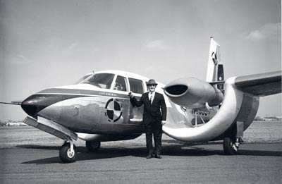

http://www.custerchannelwing.com/
Repost, but if there's air moving over the wings, there's lift.
http://en.wikipedia.org/wiki/Fieseler_Fi_156
The Storch could fly as slow as 32mph, and land in 60ft.

http://www.slepcevstorch.com/
An improvement on the original design:"The aircraft will fly at 22mph at full flap and 30% of power. Take off run into a 16mph wind is vertical with no forward roll."
