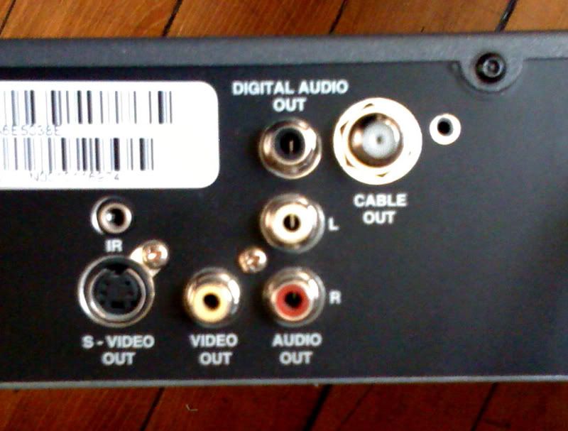

My Denon 1909 receiver turns up this weekend. I wanted to run my cable box through it into my plasma screen. What's going to be the best way to connect it? The pic is from the back of the box. It has a strange digital audio socket that I've never seen before. Would an S Video/audio cable like this one be the best option?
http://www.jr.com/monster-cable/pe/MC_THXV100AVS_hy_8/
Or should I just save my money and leave the cable box running straight into the back of the plasma with the coax?

There's no video in, so you'll need to keep your cable box as it is.
And don't get Monster Cable. It's overpriced hype.

IMO You should just run the cable box to the TV and forget about it, unless you have a DVR or a DVD recorder or something you want to record tv shows to. You're just going to spend $50 on cables and its not going to be "better" or anything. Just run the audio out to the receiver and turn it on if you want big sound for a special occasion.
Also, if you have it hooked through the receiver, you will ALWAYS have to turn on the receiver if you waht to watch tv. Doesn't seem like a big deal, but you'll get tired of it.

I think that's a pic of the cable box, phred, no the receiver.

Yeah, the pic is from the cable box. The receiver has every conceivable connection possible on the back of it.
I was thinking more for audio that picture, as then I could run it through my surround sound. I guess it's not true 5.1 though so you're right, it might not be worth the bother.

Ever seen a digital audio socket like that? I already have some phono (l/r) leads I could just run from the box to the receiver, just want to get the best quality sound possible.

Digital audio sockets like that are called coax digital audio. It's TTL level digital audio feed, hook a (nice) RCA style cable between that and your Denon. Hook the video out straight to the TV. Turn the TV on the cable's input and turn the Denon on Coax Digital and enjoy.
There are some companies that sell "high end" coax cables with gold connectors etc. If you are only running it 6 feet or so, a normal RCA cable can plug between that audio port and the denon and it will work fine. It's digital. It's either working or it's not, for the most part. Better cables won't make it sound better.

Just to be clear, are you saying a digital coax cable is the same as an RCA cable? I have a very high grade RCA audio cable with both left and right connection. Could I just use one side of that - right plug in cable box to right plug in receiver?
And then I'd need a separate video out to video in cable?

Yes, it's EXACTLY the same. They can triple the price when they put "digital audio coax" on the packaging.
John.
Yes, and I'd use s-video since you have it. It'll be the highest quality that the cable box can output.

Video:
Coax from wall to cable box IN. S-video OUT from cable box to receiver S-video IN (TV/CBL). Receiver S-video/component/HDMI OUT to monitor S-video/component/HDMI IN.
Audio:
Cable box L & R analog audio OUT to receiver L & R analog audio IN (TV/CBL).
If your receiver doesn't have a digital audio coax (S/PDIF) IN for TV/CBL, your are probably stuck with analog/RCA audio out from the cable box. The only other option would be to get a S/PDIF coax-to-optical adapter/converter (something like this). Then you could run the digital coax OUT from the cable box to the receiver's optical IN (TV/CBL).
