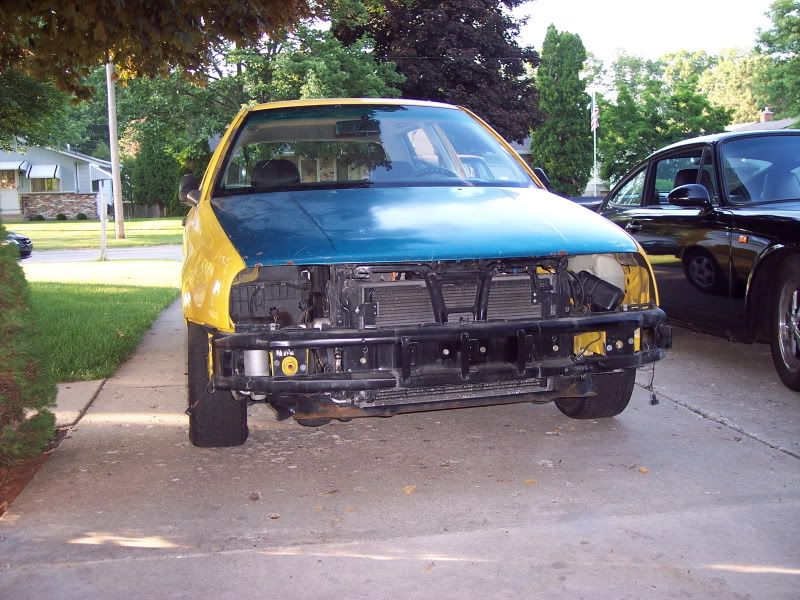

I need remove the windshield from my sons 98 GTI before I paint the car. It has a crack in it so I am going to have it replaced anyhow. Is there a neat way like maybe a wire to cut the sealer, I know I could just bust it out but would rather not. Any tricks?

Looks like the top tool is what I need, well off to the lathe to make up something!
