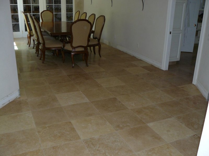

Most of the dining room is set now.

Kitchen/dining is set/grouted/sealed!

Wrapping it all up this week.
Final coat of sealer goes on Monday.

This job is done.
It looks really good.
The tiles have good character and I think they will be a lifelong topic of conversation.
The fossils throughout are spectacular!
Here's a couple more shots:
Now that I am done, baseboards can be installed, a few doors need to be trimmed, a threshold installed, carpet trimmed, stretched and tucked and furniture placed back into their proper places.
