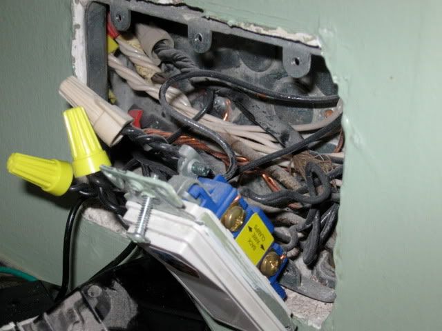

I'm trying to replace a light switch in our kitchen. The lights are on a dimmer switch. Only one switch. The switch/box is bad, as it no longer works reliably (but will sometimes work if the switch itself is wiggled). So I removed the switch (after shutting off the circuit breaker ) and am in the process of replacing it with like equivalent (same manufacturer & model #).

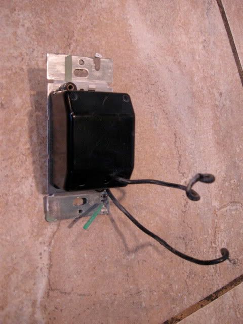

But I noticed that the previous switch has had the green ground wire clipped. (See photo below.) Only the two black wires protruding from the back were pigtailed to existing wiring in the wall. Is that OK? Can I just wire in the new switch like the previous one and cap off the green ground? Or is this a fire waiting to happen?
Replacing the old switch with a new one and reinstalling everything like it was (2 black wires, no connected ground) works the lights, but the switch (or, rather, the metal tabs used to screw it into place) gets warm after a few minutes.

the green wire should be in the bundle os bare wires in the back of the box.
if possible, position the dimmer towards the outside of the box and don't clip off the tabs on the side, the act as a heatsink
all dimmers tend to get warm, they should be sized to the load, i hope you got a 600w dimmer as a 300w may not be able to handle the load. to figure the load count the number of lights this switch works and multiply by the wattage of the lamps.
an old idea about the green wire was that the metal yoke and the 6/32 screws were sufficent to ground the switch if the box was properly grounded, now just put the green wire in with the bundle of bare wires

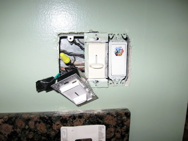

Home is 60+ yrs-old. Kitchen was remodeled at some point in the last 5-10 years, but obviously I don't know who did the work as we only moved in last year. I see no other available wires to hook up to in the jct box, but there are three light fixtures (kitchen/kitchen/dining room) controlled by this jct box. No other light switches in the house work any of these three light fixtures. There are 5 recessed lights being operated by this light switch in question.
The three switches: one dimmer switch (the faulty one) operates 5 recessed lights in the kitchen, another dimmer switch operates 2 recessed lights in the kitchen, and the third switch is a simple on/off one the operates a single light in the dining room.
There's a bundle of wires in the back of the box. I'll have to see where they go/come from. The other two switches aren't connected to any green grounds, either.

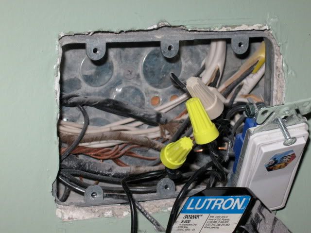

Pics:
It didn't look too awful when first removing the cover plate. But the more I removed, the bigger the rat's nest that emerged. In the last photo, there is at least one bare wire screwed into the center of the back of the box. Each of the two switches is connected by just 2 wires. The other dimmer switch (controlling two recessed light cans) has had its green ground wire clipped off, as well. The switch in question is the one to the left. I've taped off the end of the green ground temporarily.

I'm pretty sure that the twisted bare copper wires are your ground that you connect to the green wire on the switch.

the golden colored wires are your grounds, connect the green to them.
the dimmer is too small for the load, a 600w dimmer is really only good for 480w or 80 of that rating
you could probably get by with 100w lamps or 500w of load
nice job by the way, and next time don't clip off the tabs, if you read the side of the dimmer, it will tell you the load adjustment with one or both sides clipped off

The pictures didn't load for me at first. Hugh is right. The bare wires are your ground. You just don't know if they are connected down stream

it's actually an interesting box
1½ box which means that the studs are turned on their sides, 5/8th three gang mud ring multiple circuits denoted by the separated neutrals, the old cloth romex for an existing light, fed at the light fixture and back fed through the switch, the 14/2 romex for the lighting circuits
neat box, i think the grounds are tied through the whole circuit

You need more info.
I see
  1. a conduit fitting (If it goes back to the main box it provides a safety ground)
  2. the box is connected to the bundle of bare copper wires
  3. Old cotton covered rubber insulation which may/may not come from an armored cable
I am not sure what the code says about grounding the body of a light switch in a metal grounded box. The dimmer may also need a discrete ground for EMI reasons. It may be fine to provide the safety ground through the mounts, maybe a real off topic electrician will respond.
