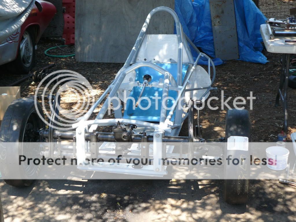

I want to run these tires/wheels on the Vee.
4x130 bolt circle. Same as on my 914.
Tires are from the Formula Mazdas:

If you are interested in the build:
Formula Vee pictures by trekkor - Photobucket

Old 06-11-2012, 08:17 PM
crustychief's Avatar
Join Date: Jun 2008
Location: San Diego
Posts: 4,409
Looks like Keith Stones car. Just kidding. Is that a mild steel chassis?

Old 06-11-2012, 08:41 PM
JW Apostate
trekkor's Avatar
Join Date: May 2004
Location: Napa, Ca
Posts: 14,164
Yes, all steel.

Old 06-11-2012, 08:48 PM
JW Apostate
trekkor's Avatar
Join Date: May 2004
Location: Napa, Ca
Posts: 14,164
1000#'s with driver.
should be fast.
I'll a/x it first.
